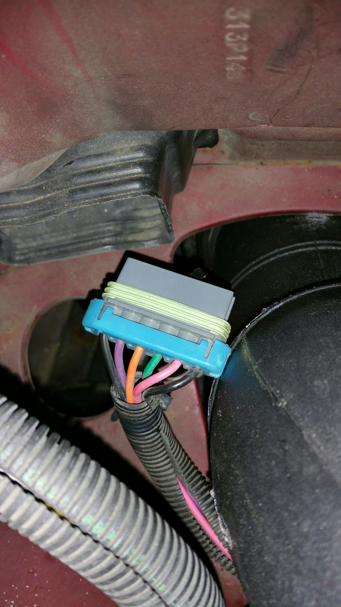

I too have removed ABS and have both the ABS & BRAKE light on. Here's a shot of the couple connectors I unplugged. I don't see what I would call a light green wire on them. Is it the green wire in the middle in the first pic?
Thanks

yes i did get it straightened out. i needed to unplug the ebcm module that is under the drivers side dash. I had to ground the light-Green wire @ the EBCM to fix the brake light on problem. i think what you (and i ) unplugged is where the abs motor was.

Oh ok, yes you're right, these are the connectors at the ABS unit underhood. I'll look for the EBCM under the dash. Thank you very much for that!
