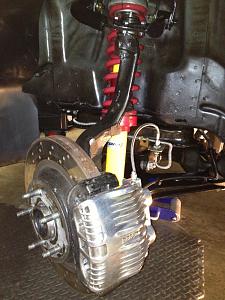

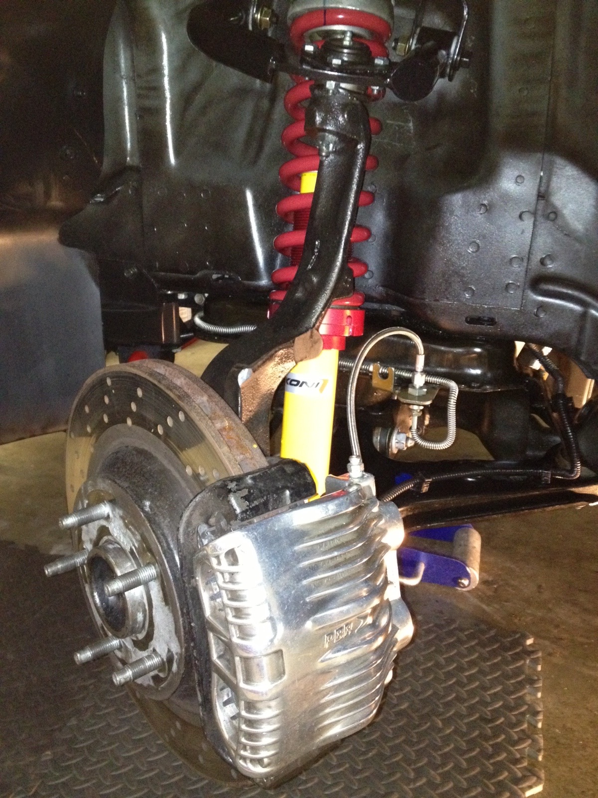

In '98, I installed Baer Track brakes w/ 13" rotors on the front of my car. Had to perform the spindle ear cutting that Injuneer described. My early kit came with aluminum PBR C4 Corvette calipers. Actually the "upgraded" system didn't stop as fast as my stock setup, so I've compensated with more aggressive pads. I would still like to upgrade to the 6 piston caliper with C5/C6 pads.
Back to the Bear Pro+ install. I believe that the 98-02 spindles have different design and mounting holes for the supplied caliper brackets. Look at the spindle pics that Injuneer posted and then look at the spindle pics from the Baer Pro+ Install Instructions
Here's the link to the Bear Pro+ install instructions:
http://www.baer.com/manuals/6000339.pdf
So, I think you need the 98-02 spindles. Like Injuneer said, just call Baer and they'll clarify.
Added pic of my setup just for grins
