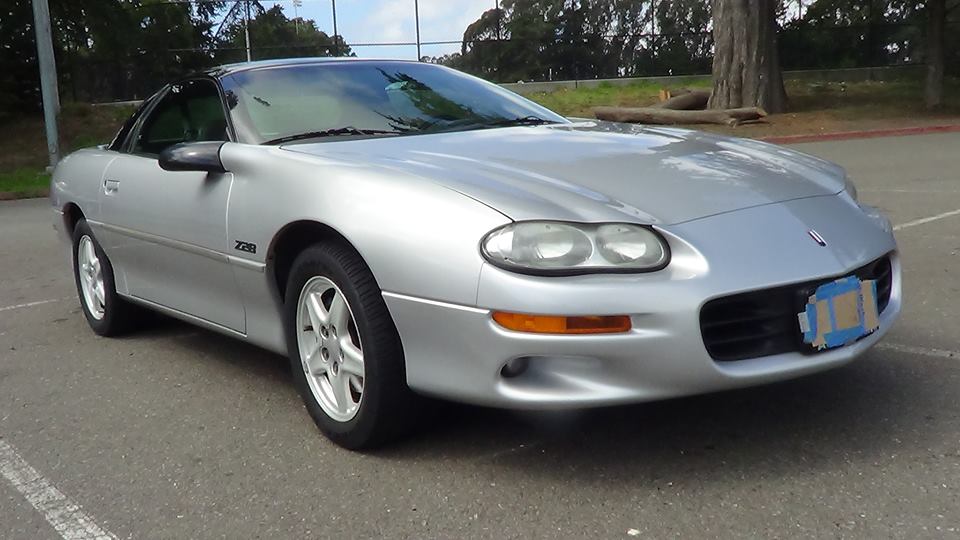

I guess that's what it is at 70 mph braked hard and vibration in the steering wheel, I know the tires new balanced , rotors don't even look warped never turned as far as I know bought car from ist owner at 64,000 milesand now has 72,000 miles
How could rotors be warped at 72,000 miles??
I read a.b.s. problems occurred also?
I think that's a dangerous situation where rotors lock and sensors and module need changing?
How wide spread are thes brake problems with the 98 z28 or all 4th gens or???
Ok its a nice car drives nice ect but don't wanna chage rotors then it be something else lika b s , I don't have inop abs so may be it is the rotors , good loking cars though,

ya know I been driving this car since 64,000 miles like a an ole man soft wasy and slow. Now with 72,000 miles I felt like punching it brakin hard cornering hard , now original pads were still there.
I saw some metallic in the pads and may be pads kinda wore the rotors some ,.
Now these rotors are original as well.
I had bought some pads while back and today decided to install them.
I did then test drove car they felt nice no 70mph and slamming brakes but 50 mph , no abs light , no shimmy at steer wheel
I did notice torn dust seals on calipers also original, no leaks. Eighteen year old car that was outside enough to crack some rubber around in suspension.
I I guess its lower control arm bushings, maybe dry ball joint boots some crack, point is 18 years its not easy on rubber and torn rubber leads to broken down components.
judging from out and inside you would never know.
Im thinking may be smarter for me to find a buyer seems will be easy and replace it with a garge queen crean puff if possible.
Your point about small things making a difference in pedal feel ect I agree with !!
