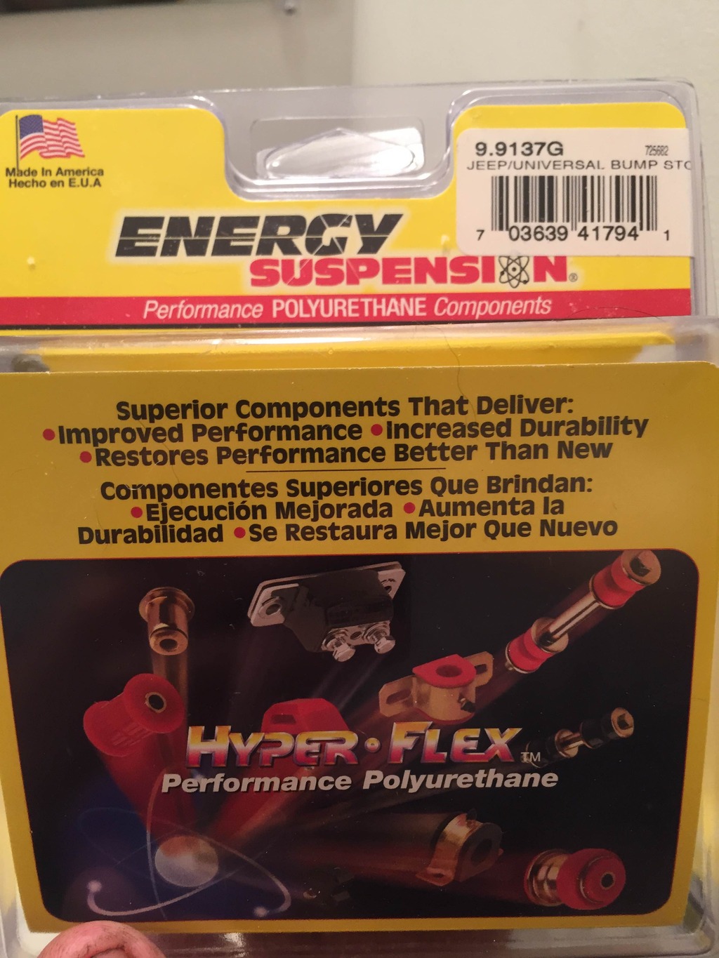

Here's the bump stops you would need.
There is a way where you can cut the fender wheel well and directly attach the new stop. But then you have too much travel. This way it is as close to stock as you can get it with or without getting an OEM stop. I have a bench grinder but it's a cheapo version and doesn't have enough HP. So I put the spacer in a heavy duty vice and filed away and cleaned it up real nice.
