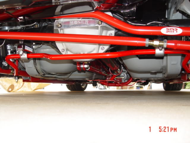

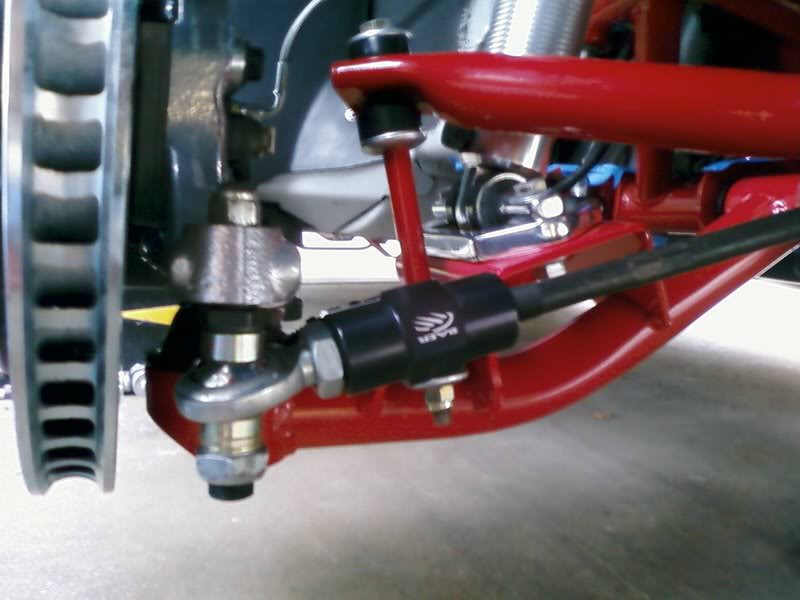

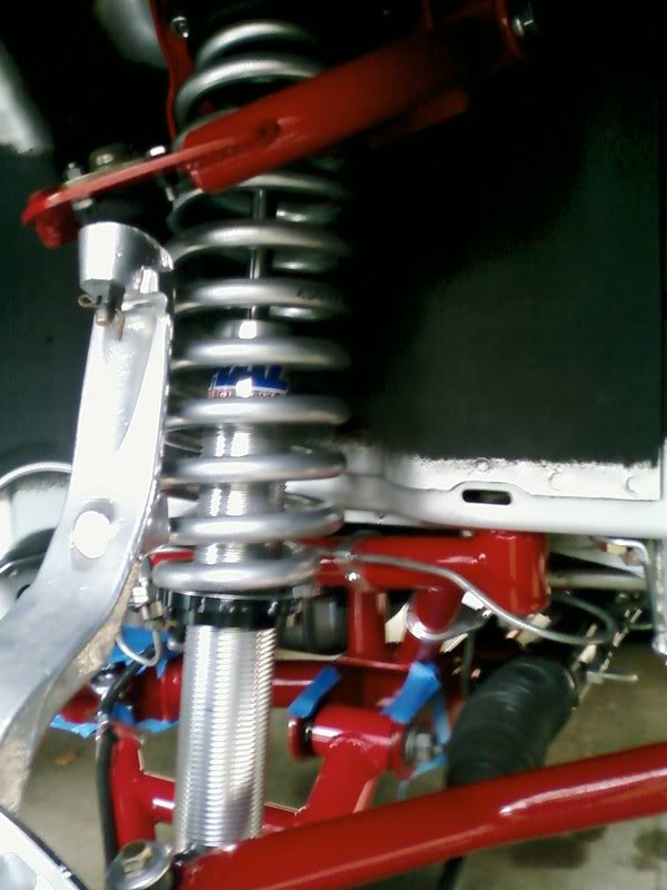

I'm running the HAL QA1 12 way coilovers at all four corners and I used the 300 lb linear rate QA1 spring up front, rears are the 150 lb linear rate QA1 (I think, maybe 175 lb ?). The car has BMR / Strano / etc. everywhere with a street / track alignment. To be honest, QA1's are probably not the best springs you can run for daily driving, but they perform much better than I would have expected on the street. My car feels very good when aggressively driving the package on twisty roads, plus a good compromise for the strip. I'm sure having a complete suspension setup will make a huge difference, still impressed with the street performance of the (dis-advantaged) QA1.

nice setup - aren't the stock LT1 springs 292 front 110 back? my car never rode so well as when it was stock.
Old Jun 23, 2008 | 09:17 PM
96SilverRam's Avatar
Joined: Jan 2003
Posts: 780
From: Tejas
I think your front numbers are correct, but I thought the rears were a little higher rate spring ? I would agree a totally stock WS6 suspension rides pretty good on the street; although, this setup is pretty close on a street ride and it handles damn well when it's pushed.
