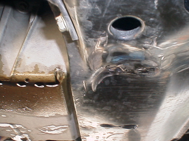

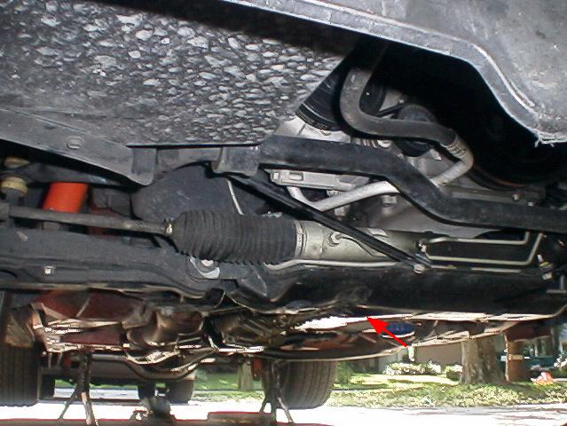

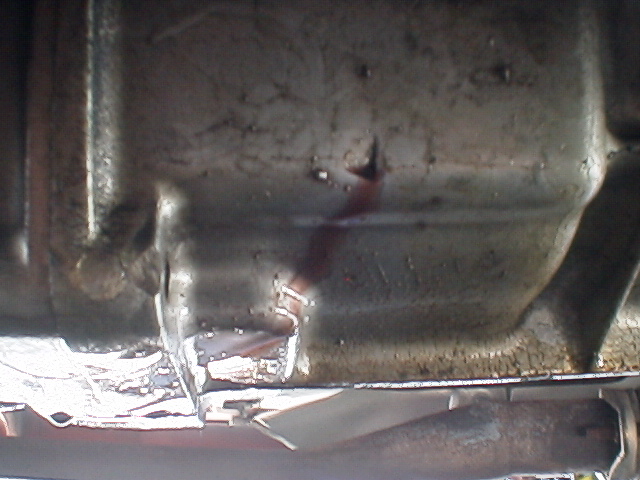

I slapped some JB Weld on the punctures. If they hold, tomorrow I'll bend the exhaust brackrt back in place and fill it up with lubricants for a test drive.

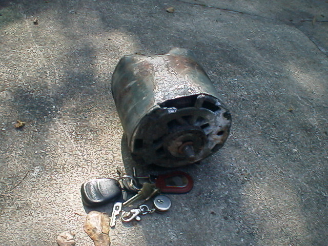

Here are some pics.
http://2002.cz28.com/Debris.jpg
http://2002.cz28.com/OilPanLeak.jpg
http://2002.cz28.com/Bent_K.jpg
http://2002.cz28.com/T56leak.jpg

Sorry to hear about your continuing bad luck. If the JB Weld doesn't work then I'm pretty sure the holes can be Tig welded shut pretty easily considering the oil pan and tranny case are both aluminum. From the looks of it they could probably do it on the car if you could find someone willing to come out to your house.

I've already cleaned it up real good and slapped JB Weld on the two leak areas. It seems to have bonded pretty good. Plus, neither spot has any structural stress or pressure on it so it should be okay. I just removed the cross brace that the exhaust was rubbing on for now. I was planning on driving it to work tonight but tried replacing the sway bar while I was down there. Then I found there is a stupid bracket on the driver's side that was gonna take a few minutes more to get out. Didn't have time to finish so it'll wait till tomorrow. Almost back on the road.
