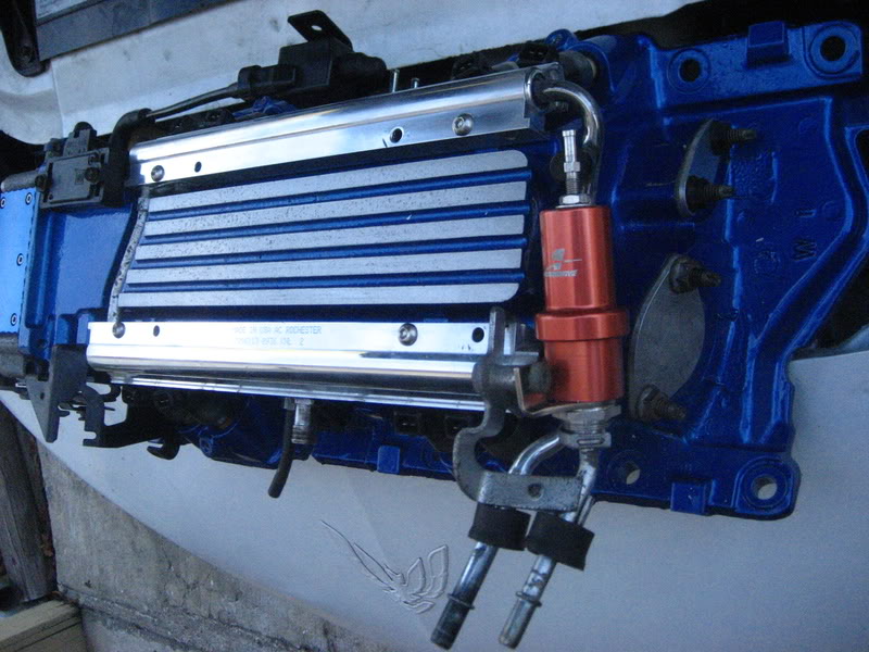

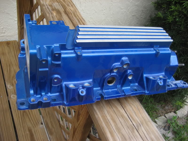

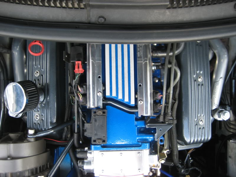

heres mine with normal powder.
This is a very good shop. My buddy owns it but before he did I used them.
http://cfpowdercoating.com/

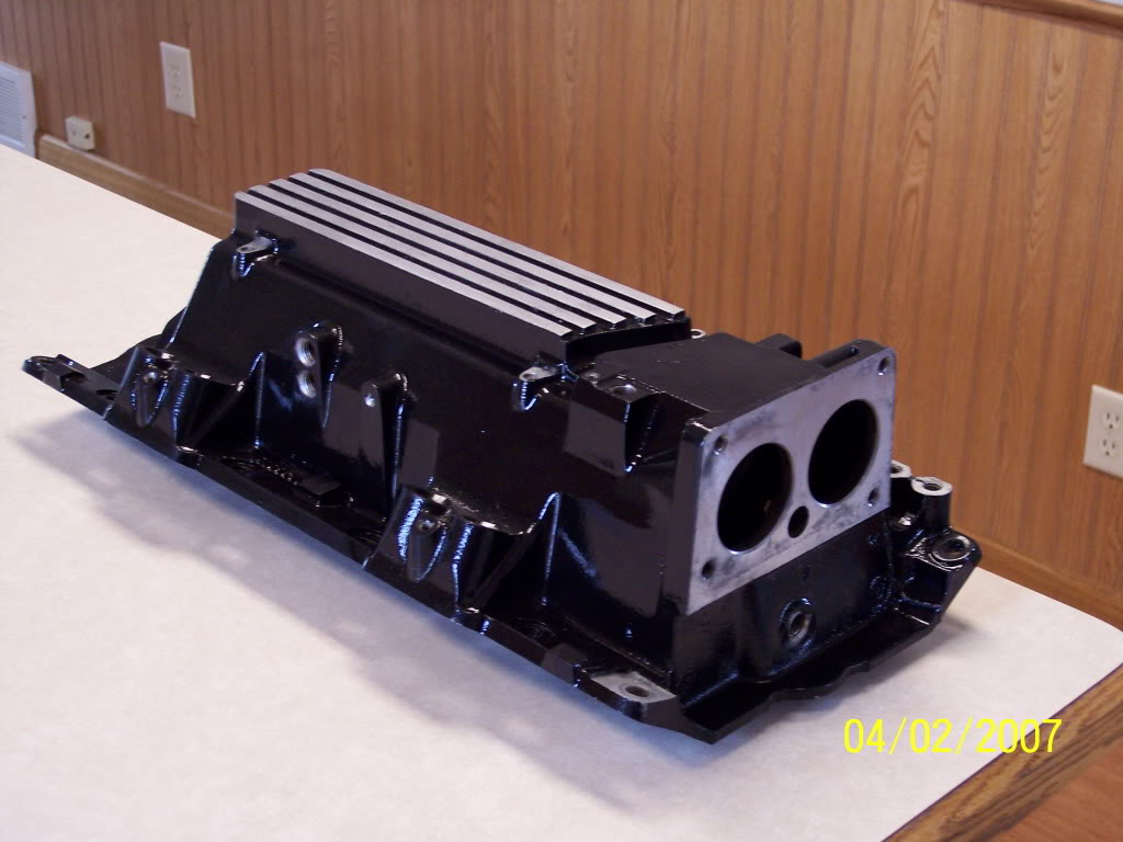

I wish that I had done mine in something other than black, you can hardly see mine.
This is definitely the perfect thing to do to your intake when you're doing the lovely intake leak repair too.
