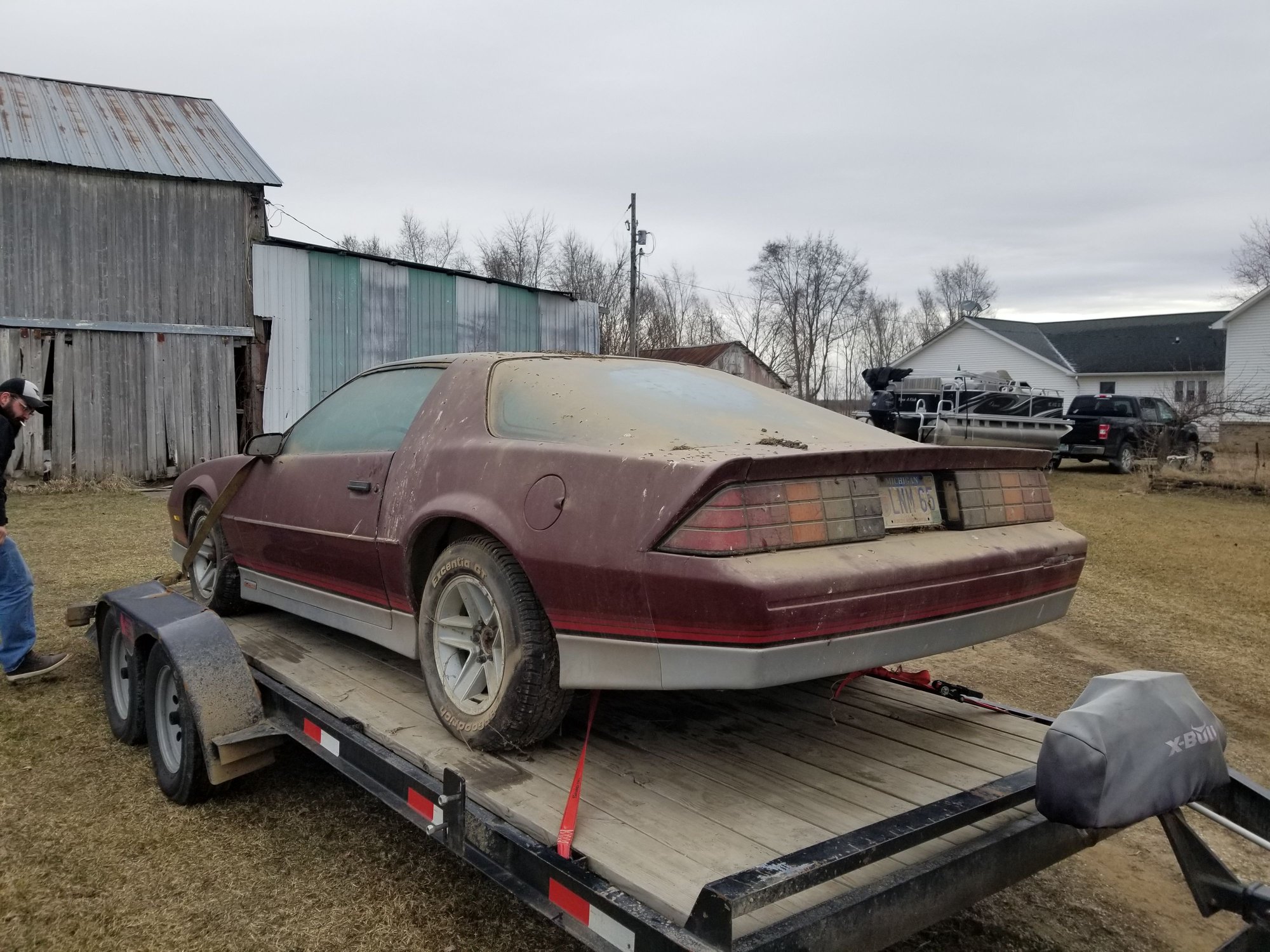

Figured I would join the forum and see what I can learn. Just got my hands on a 1985 305 V8 Z28. HAd not run since 1988. Broke the engine free and did some very basic PM and plugs, wires, cap and rotor. I have the car turning over and actually starting while being fed from the bowl not the tank. Will hold an idle....sort of LOL.
What next? I am going to change all the belts and hoses. all fluids... vacuum lines, and do a carb kit to clean up the 4 barrel factory. What am I missing!?
Look forward to meeting everyone. I will post more pics as time goes and may even do a couple videos.
so much pigeon and bat poop
The day i found her and took her home.

Great find. Lots of work needed - basically replace every fluid in the car - coolant, engine oil, trans, rear axle, brake fluid, fuel. Check all under car lines for corrosion and damage. Replace all filters - engine air, engine oil, trans (if automatic), fuel filter. Check radiator cap for pressure rating, check fuel fill cap for correct type, replace PVC valve, O2 sensor. Check coolant and intake air temp sensors. Check brake calipers for frozen pistons and corrode slide pins. Examine all suspension bushings for cracks, wear. Probably a lot more but that's good for starters.
Replace tires.
Glad to see a 3rd Gen owner join the site. Seems like the only people who come here any more are 4th Gen LT1 owners.
