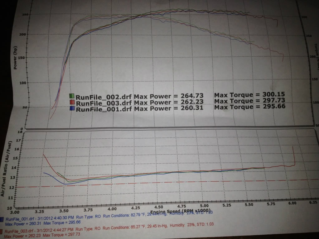

here's the dyno sheet

You dyno sheet indicates the A/F ratio in the typical 12.8-13.2:1 range that typically produces good torque/HP. That would indicate the PCM has been tuned, because the stock LT1 programming has an overly rich target A/F ratio in power enrichment mode of about 11.7:1. There is some evidence it's lenaing out slightly as it approaches 6,000RPM, but that's not bad. It would indicate you probably are not having fuel problems.
Your rwHP is consistant with a near stock(CAI, headers) LT1 through an A4, with a PCM tune.

I would expect your numbers to be between 15-20hp higher, I have a 96 a4 (stock stall) with intake and long tube true dual set up with a pcm4less tune that put down 293hp and 316tq. Before my auto I had a bolt on M6 LT1 with similar mods that put down 302rwhp and 330tq. given you have mids i would think something in the 280hp range. Something is off and it may be related to your ideling issue. Your on the right track and you have some of the best people helping you out in this thread, good luck to you!
