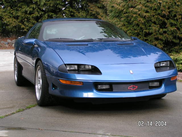

Assuming you're talking about 17X9.5" there is some wiggle room. I'm having no problem with the 38mm offset AFS': http://www.jonaadland.com/NewPics3/Weelsoutside.JPG . They stick out farther than the 56mm, so whether or not you like that is a matter of personal preference. I got them mainly for increased track and brake clearance. They also go a little more cheaply than the "Camaro offset" wheels on Ebay.
They fit with no modifications.
