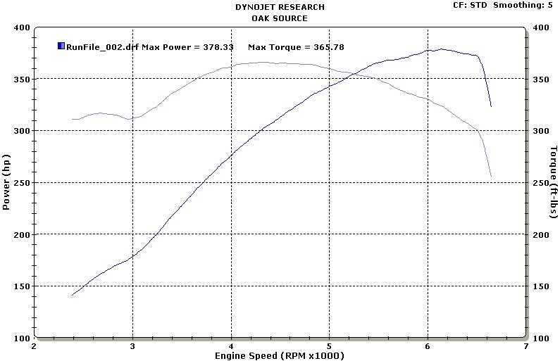

There is hope, I loved my CC306. I'm running a midsize cam in my DD and although low end is better it's not as fun. If I had the chance I'd run a CC306 again. Guys who get their stuff running right make 350-365 cam only with a CC306 and over 400rwhp with decent heads. I've seen 428rwhp through an auto and 9" rear [GTP LT4 heads]. Having the bump in compression will help out that CC306 as well.
Here is a 350, CC306, stock heads with LT4 valves, 11:1 compression. 6800 isn't necessary, peaked at 6300ish.
Let it eat!
-Dustin-
