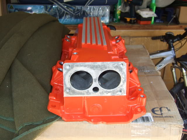

Got my intake back from the powerder coaters but they left a cork (I think) in a hole that's in the front of the intake, below the 3 holes for the throttle body. Does a bolt go there to block it off or is it for a vacuum connection? You can see the spot in question in the picture, it's the painted round part down by the bottom.

PCV connection.
edited to correct brain fart.
Old Apr 24, 2009 | 05:32 PM
Posts: 71,094
No. In the 95-97 LT1's that is where the PCV valve vacuum line connects. In the 94's, it is plugged with a pipe plug. Not sure what, if anything was attached there in the 93's.

Thanks guys! I'll check into those. I hate all these vacuum lines, too easy to forget which is for which.

Yeah you are right, I knew what it was just typed wrong . I am going to go back and change it to avoid confusion.
I believe that hole is missing on the 93s
Correct, there is no PCV connection on the front of a 93 manifold.
It's on the side of the manifold, so the PCV tube is a U shape.

When I switched to the vented opti, I used that hole to mount pcv vac. line .

Is this the connection with the metal line with rubber connectors on both ends?

When you put the tbody on , I think that hole will be covered?
Nope
He's not asking about the open, black hole right below the throttle body bores. He's asking about a hole about 2" below the TB bores, that has a cork in it, and is covered with powder coat, making it almost invisible in the picture.
