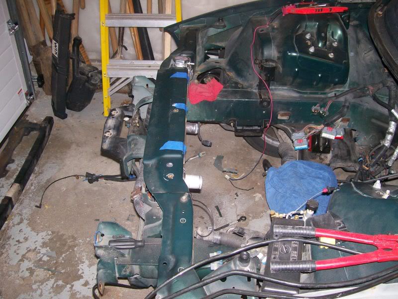

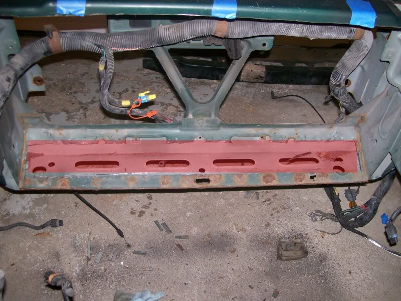

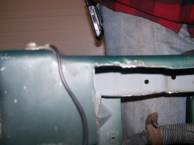

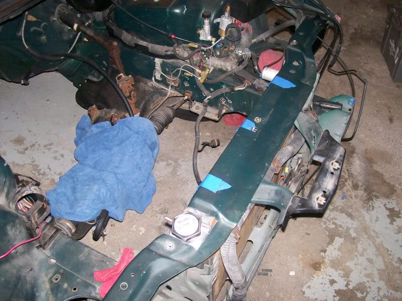

it took me probably 1.5 hours of cutting. (mainly waiting for my compressor to keep up, and stopping to see where else needed cut). Its really not hard, just requires some common sense and patience to get everything how you want it.
what needs cut on bottom. I cut just above the pinch weld then rolled the remaining lip over with a hammer.

top side pics:

radiator in:

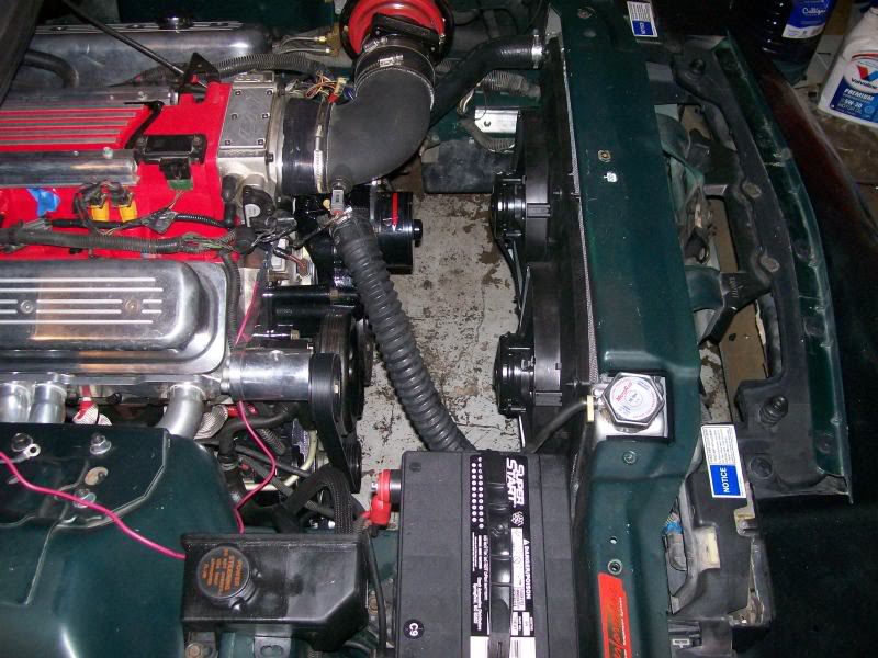

put together, excuse the temporary filter:

in action

damn, thats exactly what i wanna do. any chance you know the part number for the rad? and where you got it? ive mostly seen guys who cut the entire top away and use like 1/2 by 1/2 bar and weld it in, id rather do exacly what you have done here, also how did you attach it? i havent torn mine apart yet, so i cant really tell what you had to cut away from the bottom. is it just kind of a hole that you had to cut for the rad to sit in? also what fans did you use? thanks for allll the pics man they really helped me to decide, this is deff the way im gonna do it, just got figure out how you mounted it up. thanks man!
