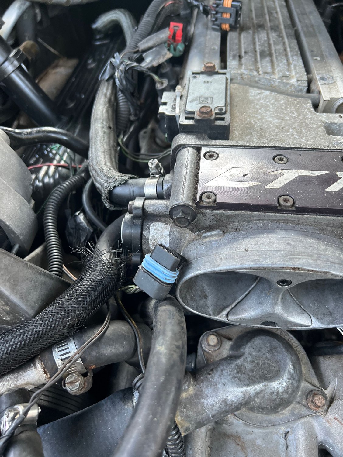

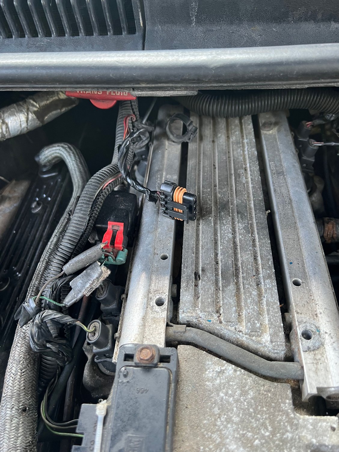

Also, being unfamiliar with this engine, I did find two loose plugs. Unsure if they are supposed to go to anything.
Old Sep 10, 2023 | 09:59 PM
Posts: 71,121
Re: Troubleshooting a no crank/no start situation
Blue one appears to be the idle air control motor at the base of the throttle body:
http://shbox.com/1/iac3.jpg
http://shbox.com/1/harness2.jpg
Yellow appears to passenger side O2 sensor, on the Y-pipe below the exhaust manifold:
http://shbox.com/1/harness3.jpg
The big picture, clickable for closer detail (very few differences between 94 and 95)
1995 Z28 A4 Engine Harness

Thank you. I'll match those up when I start pulling the plugs later today.

The portions of the engine harness visible in the photo look a bit ratty.
