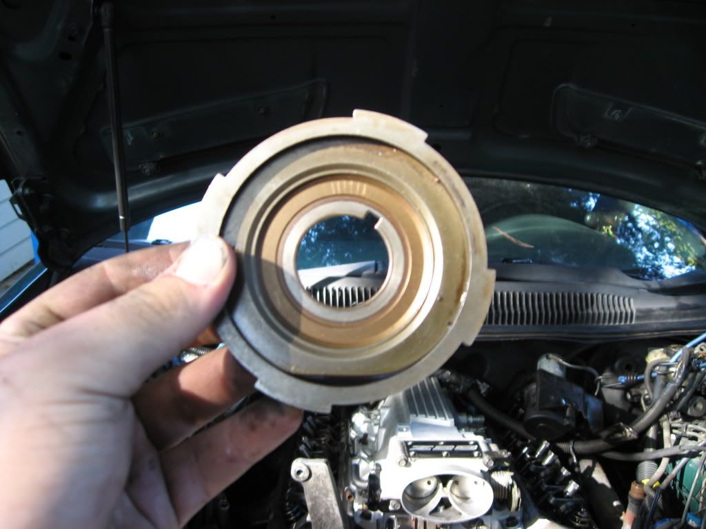

Where does this thing go on a 97 camaro? I seem to remember it going on the front of the crankshaft sprocket under the timing cover but I might be wrong. I don't see it in any of the diagrams on shbox.com.

b/w the hub and the crankshaft sprocket.
Thank is your reluctor ring for the crank position sensor.

Then you must have missed this one.

You're right, I did miss it. I knew it had to be there somewhere!
Thanks guys.
