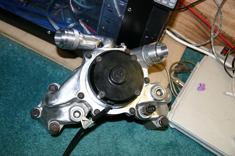

Originally Posted by T/A KID
thesoundandthefury
I noticed you plugged the coolant sensor in the waterpump??
What is your thought on that??
I got the idea from this:
http://www.carolinarodshop.com/miscserv.htm
You can't see it from that angle in the above pic, but I drilled and tapped a new hole for a 1/2" NPT pipe bushing on the bottom of the pump. The coolant temp sensor and wire will be hidden when viewing the engine from the installed vantage point.
Details that help win show trophies.

I got to remember your a show car type of guy, lol. Looks neat, never seen it done before.

Glad you posted this Ben. I was leary of the welding. I had thought of tapping it like Mdacton. Looks like a good way to go.

Did mine tonight while at work. I did exactly what Mdacton said and it worked great. Tap used was 1/2-14 and plugged it with a 1/2 pipe thread plug.

you said u tapped it with a 1/2 -14... doesn't it have to be a special tap for NPT

"Pipe" threads are tapered, so as long as the tap you use is a 1/2"-14tpi NPT, it will work just fine.

where do u guys buy the npt taps, i have one machinery type shop that MIGHT have them... but as far aas like sears or home depot, definatly not a stocked item.

plumbing supply place should have them, I will just go to the machine shop if I don't have one and tell them what I need. They never charge me and I will cut the threads myself while i'm there

I actually ended up having mine Tig welded and it look awsome, since then I have had a -16 and -20 welded onto the waterpump and I am running braided line to my griffin rad. Looks SWEET
Im putting 2 -20 fittings on mine and runnign braided lines to my griffen
