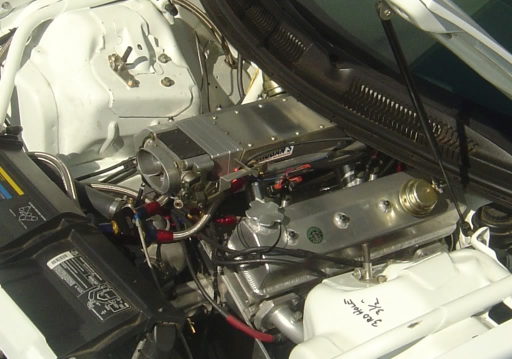

member here

Originally Posted by slowride94z
member here
That's my motor and my spacer. The background on the use of that accessory was two-fold:
1. The Hogan manifold as delivered did not provide adequate space for the use of the stock throttle linkage mechanism and required moving the throttle body forward about two inches so that everything would clear. When I built that motor in 2002, the NHRA rules required a box-style plenum and expressly barred us from using a single-plane manifold with an elbow. More recently, NHRA has recanted that restriction and permitted a single-plane/elbow. This car, with this manifold, even though it is now almost 10 years old is still very competitive. I sold it about three years ago.
2. The motor is an LT1 solid roller motor built to meet NHRA Super Stock rules and it operates in the 8000+ RPM range. It seemed that there would be no downside to expanding the volume of the plenum since plenum volume at high RPM could conceivably be at a premium with a stone-stock throttle body. We machined the spacer in multiple units so that we could add or subtract length if we wanted.
Because of the clearance problems with the throttle linkage, the engine was never run without the spacer. It didn't seem to hurt to have it there. In 2004, the car set the NHRA record in SS/IA at 9.74, 135.80 with the motor in the picture that was built in my backyard.
c

and cnorton still lurking I see hope you don't mine me reusing your pictures
No problem 94z. Most frequently, my stuff is on the outer fringe of practicality for normal people but if, at some point, it helps others with their thinking, it's all worthwhile. My Dad told me once that it appeared as though the purpose of my life was to merely serve as a warning to others! If hearing your own father lay that one on you that doesn't provide reason for reflection, there's no hope.
