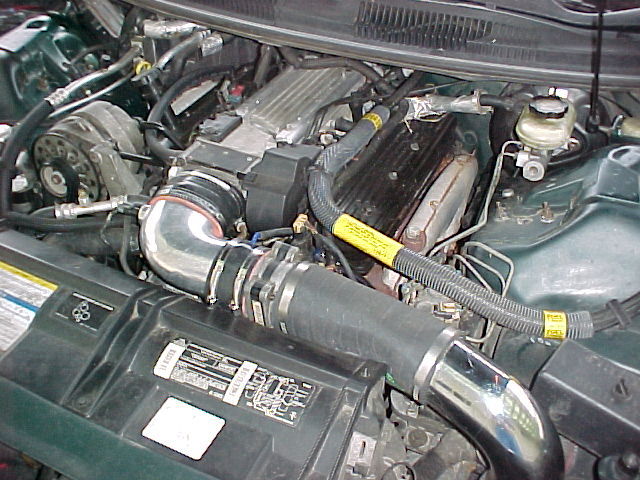

My stocker had a big rip in it and I didn't want to spend $100 on a Vortech or $70 on a 1LE so I took a gamble and bought one of those $40 Mojo Motorsports elbow kits off of ebay. I had done some searching on here for info about it and I didn't find anything promising about the fitment or the quality but I decided to go ahead and get one anyway. I must say that I was pleasantly surprised with both the quality and fitment. By the picture, I was expecting some flimsy thin piece of aluminum but it's actually pretty thick stuff, about 1/4" I'd say. It fit absolutely perfect, even with my AS&M CAI. Everything I needed was included and the install only took about 5 minutes with no probs whatsoever. The only downside is that it's pretty dull compared to the shiny polished vortech's but I'm not that picky so it doesn't bother me one bit. Plus it looks 10x better than the stock elbow. So anyway, if you want a cheap replacement for your stock elbow I'd highly recommend looking into one of these. If I remember, I'll snap a pic of it on my car when I get home.

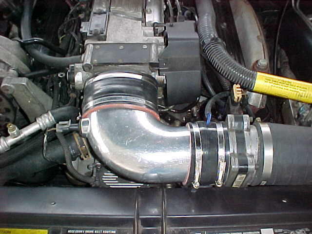

Good thing you guys mentioned that about the opti vent line, I wondered what that hose was for. lol When I pulled it out with the old elbow it wasn't connected to anything on the other end so I just left it off. I guess I'll have to drill a hole and get that hooked back up when I get home, that will give me a good excuse to snap some pics too. Should have them up in a few hours.
Old Apr 12, 2006 | 03:10 PM
J Rod's Avatar
Joined: Jan 2001
Posts: 111
From: Ft. Wayne, IN
Re: For those of you looking to upgrade your stock elbow
Here are some pics. All I did for the vent line was take a punch and poke a small hole into the coupler, then fought like hell to shove that little blue fitting in there til it popped into place. I would think it should seal pretty good as tight as it is, but if not I'll just find a grommet.
