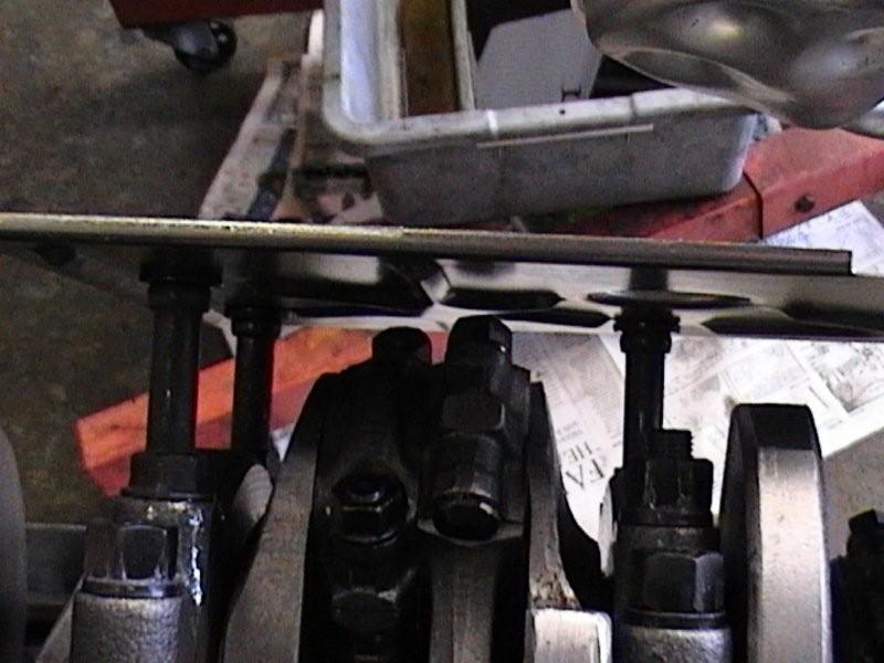

on stock pan & windage tray just use 1/8" washers between tray and nut to hold up the tray higher, no problem. Use the 3 stock extended studs or Miloden makes longer ones
Your stock pan should also clear but first put on with no gasket while motor is on stand and have someone turn engine over as you hold your ear to pan. You "may" hear a slight scrape from #2 rod bolt. It would leave a witness mark (scrape) on pan if there is contact. There was on mine and I just used a folded towel to place pan on and used the large end of a wood base ball bat to push out from inside. It took very little effort. Likely did not need to as the pan gasket adds about 1/8" between block & pan
