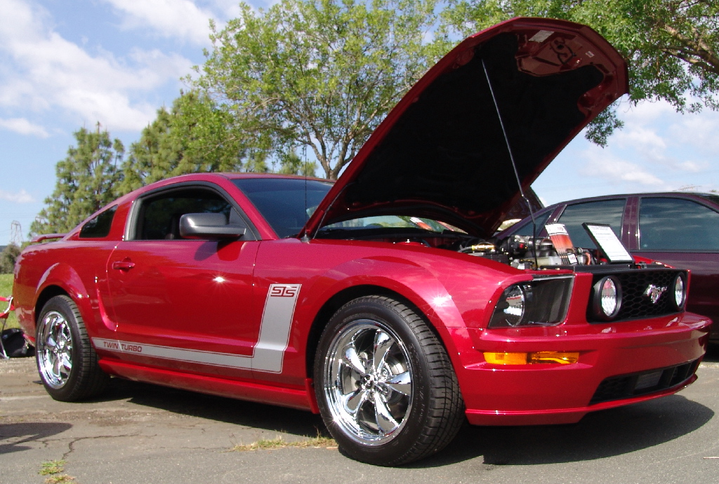

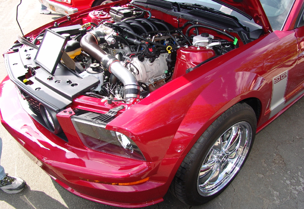

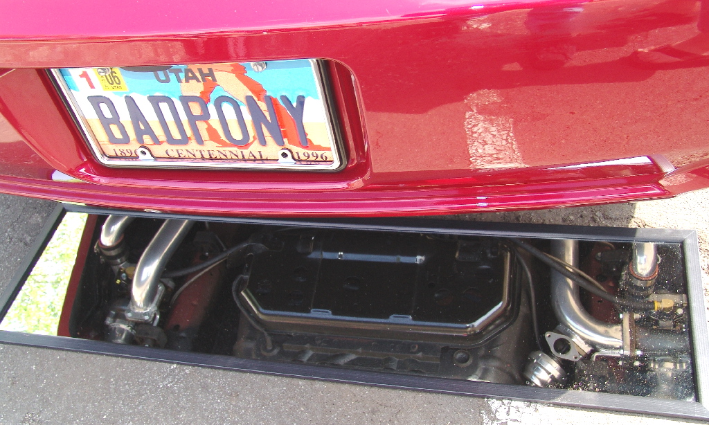

STS is doing rear mount twin kits. The UFBA President had her husband's 2005 Mustang done by them. Check out the links:
http://www.kickinrad.us/images/pamstang/fullshot.jpg
http://www.kickinrad.us/images/pamstang/engineshot.jpg
http://www.kickinrad.us/images/pamstang/rearturbos.jpg
MAx horsepower was 446 and max torque was 483 on a Dynojet at Dr. Gas in Sandy, Utah. I'm not sure whwere they are with developing one for the F-body, but I assume it can be done just as easily.
Sorry to hijack the thread, but I thought this information was pertinent.
