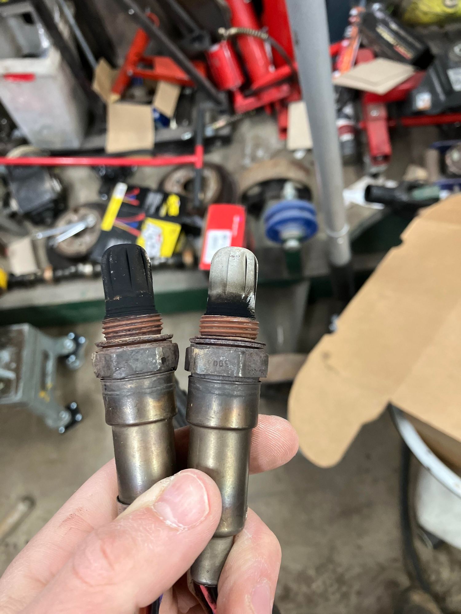

One O2 looked a little weird on the graph intermittently (would fluctuate like it's supposed to and then go flat for a while, then back to normal), so I replaced the O2s. That fixed the O2 readings, but did not fix the lean condition. See the attached photo of the O2s that came out, passenger side is white.

So to sum it up, we're adding fuel on the driver's side (B1), not doing anything on the passenger side (B2) but appear lean on a wideband, and appear to be running lean on the passenger side, based on my white O2 sensor...

Took a look at the O2 sensors in closed loop. The Bank 1 numbers seem normal, with a range of 0.004 - 0.892 volts (a little low on the rich side) with an average of 0.428. That would seem to confirm the system is adding 19.5% extra fuel on the left side to keep it from leaning out. But there's something weird with the B2 numbers: range 0.018 - 0.835 volts (again a bit low on the rich side), but the average is only 0.271 volts. Ideally, you wan the average to be 0.450 volts, indicating the sensor is cycling back and forth from rich to lean correctly. But why is Bank 2 showing such a low average? Would seem to indicate a lean condition, that isn't being corrected with the 2.3% addition on the 131 LTFT.
Color coding the high vs low readings on bank 2 seems like there are periods when it just hangs deep in the lean zone (slow response), then hangs in the rich zone (slow response).... but not high in the rich zone.
Where is the wide band located?
What brand are the replacement O2 sensors?
Try swapping the O2 sensors side to side. If the keeps everything the same, try swapping the injectors side to side.

They're Bosch O2s. I've never had an issue with them on other cars, but seems like they maybe have some mixed reviews here? The lean issue does pre-date the sensor swap. I can probably do a swap side to side this weekend. I could even swap the originals back in and from side to side (didn't get rid of them, and it's pretty easy to tell which was where). The wideband is about 8" back from where the two banks Y together. I considered swapping the injectors, kind of kicking myself for not doing it while it was apart, but, oh well. Pretty quick job, anyhow. Is the low average more likely indicative of a bad sensor or of a bad mixture that the sensor is picking up?
