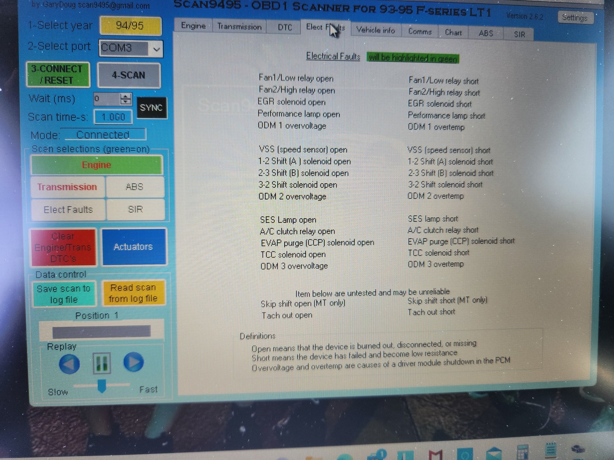

Team those are my readings as far i could see i don't see any code or open /short electrical issue however the car turn on the SES light in around 1min. After the car is on and then both fans turn on and car start running very rich , both O2 sensor are new ,new opsticspark ,new ICM , new injectors, and I have no idea what else could be , EGR was deleted but I am not sure if that could create that issue without any code, an old school mechanic told me it could be a bad PCM due to the symptoms , I just want to see what you guys think it could be before I invest in a new PCM or if I missed something on the scanner that you guys see , please any help will be appreciated, I am In Tampa florida in case there is any z28 club around my car once is running great I will paint it and add more love for now my priority is make it run good again.

You would be much better off starting your own new thread, rather than tacking it on to someone else's old thread, where he was looking for advice on which scanner to buy.
You also need to give us all the details of your vehicle….. year, engine, trans, and any significant engine modifications that would affect the scan data. One way to do that is to add a “Signature”:
https://www.camaroz28.com/forums/lt1...nature-879835/
When you do that I'll spend some time looking at your screen shots. But you have to understand that screen shots only scratch the surface of data collection. Data logging with the car out on the road provides a lot more usable info. That said, you have obvious problems with the IAC and the B1 LTFT.
For example, I suspect the reason you have no codes is that the PCM has been “reset” (either intentionally, or simply by disconnecting the battery). Many codes can only set with the engine running, under load, etc. - the EGR code would be a prime example. The fact the 10:43 shot has a 160 in the B1 LTFT, but the 10:49 shot has all 128’s would seem to indicate a “reset”. A log also shows all the sensor and parameter values at the exact instant a code sets, along with the specific code.
