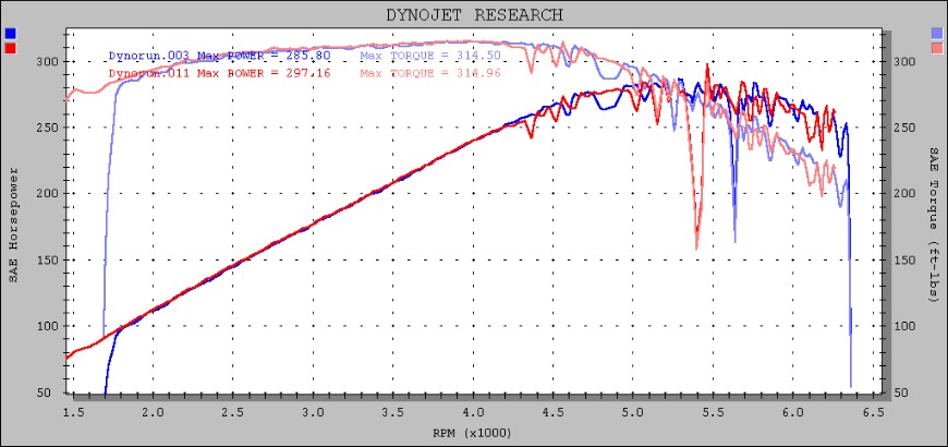

Hey dude you seem to know ur $hit pretty good so I'll hit you with the question. When I had my car Dynoed my trend looked pretty $hitty after 5K or so there was 10-15 hp/tq spikes and drops. My a/f ration dropped to abt 12.5 on the start and hung tight through the whole run so I don't see a fuel issue. Also I don't see a misfire issue either useing (autotap). Do you have any idea what else could cause this ? The guy told me it was from vibration (high speed) 2.73 gear topped out @ 177mph. But the only reason I don't beleive that is because I had a previous run before my header install that was smooth..all other mods were the same. Could it be false knock retarding timing ? I logged a run down the strip and showed a max knock 12deg but I was already off the throttle then.. I asked this question once before and also got on a thread with another guy with the same prob and nothing. Also that other guy had his done at the same place as me, could it possibly be their dyno ?

It's likely an ignition problem. I had a similar one:
http://www.jonaadland.com/NewPics3/Dyno2.JPG
I replaced the coil, ICM & PCM:
http://www.jonaadland.com/NewPics3/Baseline.JPG
So for me, one of those three fixed it. Next on the chopping block would have been the Opti.
For you, since you just put on headers, plugs & wires should definately be triple checked.
