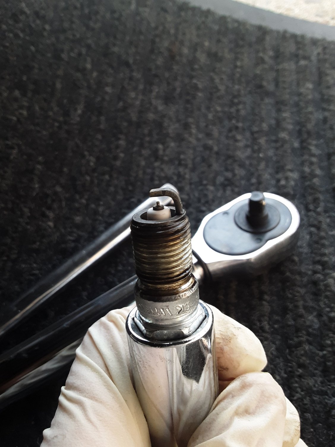

You stated that each time you changed optis, you changed spark plugs. Correct? Do you use the same type plugs each time? What do you set the gap at? I don't know if it is just the picture, but that gap looks really wide. Never tried the platinum plugs--I always stick with Autolite and they have a good reputation. NGK is a good one too. I think I would just stick another brand of plug in there just to try and see what happens.

Its been a while since I pulled the plugs on an LT1 but that gap seems huge. With added cylinder pressure from the hotcam, why not try tightening up the gap to 0.035" from the stock. When I out the 846 cam in my car tightening up the gap improved driveability significantly. Its a free fix if it works so it might be worth a try.
Also, are the plugs you're running the same heat range as stock?

Not all plug manufacturer's use the same basis for "heat range". You have to use a conversion chart to compare brands.
Factory plug recommendation, per the factory service manual - AC Type 41-943 gapped to 0.050"
I strongly recommend the NGK Iridium plugs for normally aspirated applications. Superior to double platinum plugs. In fact, it was common for the stock AC Delco double platinum plugs installed by the factory to lose one or both of the tiny platinum pucks - mine did, and end up with huge gaps that caused misfires. Hopefully AC Delco has improved them over the last 20+ years.
Stock heat range NGK would be the TR5. The iridium plug is TR5 IX (7397)..There is also a TR55 IX, (7316) which is pregapped to 0.50" (always check gap before installing). A slightly cooler plug would be the TR6, but that would be useful for a bit more HP than you are probably making, or a power addeer.

NGK TR55 gap at .050 or Autolite 104
A mail order tune based on your mods would be what you need to do to allow the car to run right with the mods you hve assuming you don't have some mechanical or ignition issue Solomon or Jesus Christ can't make the car run right with a tune if there is a underlying mechanical problem
If you have never taken the cap & rotor off the look inside a opti you should to confirm it does not have any oil inside. leaking WP drive seals or the rear bearing on opti worn will get oil inside the opti and once it does get on optical sensor you will have misfire. Opti can be easily cleaned if this happens

Yep I definitely agree, unless the car is mechanically sound completely then a tune is almost a total waste of time and money. That's why I'm trying to track down the issue before throwing any money at that. Seems at this point I've got a few places to check for issues later today. I absolutely hate doing plugs on these cars, the driver side is ok but once you get to the passenger side you can't even see crap, let alone get a spark plug socket on one.

I don't own one unfortunately, I'll see if any of my local parts stores have any in stock or I'll just end up getting that guy. Yea dropping the starter out is the best option as I've noticed. #2 is just the problem child for sure. Thank you for the info, will definitely help when I swap the plugs over real soon!
