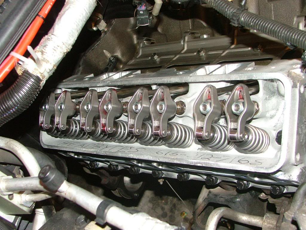

Re: Roller rocker arms?
These work for the time being.
