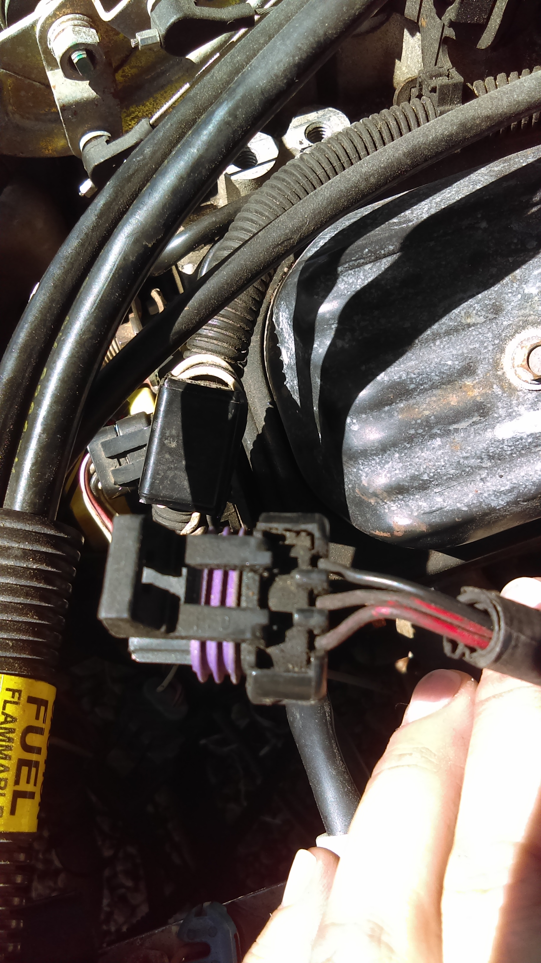

This week, I replaced the Opti on my 1993 Z28 (again). I got everything back together and attempted to start the car, but it just cranks and won't start. I double checked everything, and everything is connected except for this lone connector I can't find a home for. It splits off from a wire loom that comes out of the driver's side firewall, and it's purple with two red wires and one black wire. Does anyone have any idea where it goes? I'm stumped because I pulled the car apart a couple weeks ago, and I can't remember if I disconnected it when I pulled everything apart.

Could be for the AIR pump, factory wiring diagram shows one black and two red wires to a 3-pin connector. Would not prevent the engine from starting.

I'm following the wire bundle coming out of the firewall and I see one set of wires from the loom going to the dash under the windshield washer,then the next one going down under the fender I guess for the wheel or something,then the next bundle (3) plugs going to the abs box,then another plug going to the air pump.Hope this helps.
