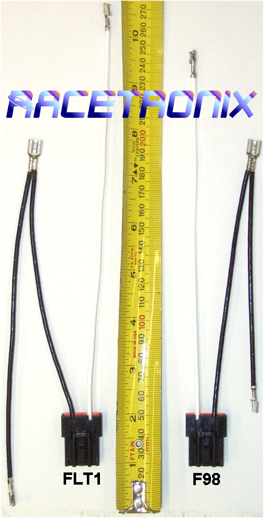

Well the racetronix fuel pump went in all fine and dandy but the black wire is too short to reach the spade connector on the fuel sender and pulls out. I am kinda mad about that cause now i can't finish it till next week. I guess i will just make a jumper harness to reach. Racetronix PLEASE make your wires a little longer!!!!!!!

Making a jumper wire shouldn't be that difficult. Just splice in some longer wire.
My wires were perfect length, although I have the GSS307.

They are revising them to make them longer. There was a recent post on here saying so. Maybe you should contact them for support.
Please contact the vendor from whom you purchased you system.
Racetronix has sent out replacement in-tank harnesses to address this problem. Do not cut into the harness to extend it!
In the future please contact support@racetronix.com for quick answers to your support questions.
Please see this picture for details:
http://www.racetronix.com/images/Fue...T1_harness.jpg
If you have the F98 harness in your FLT1 pump kit please contact your vendor for a replacement.

Thanks for that info! I will contact the vendor.
