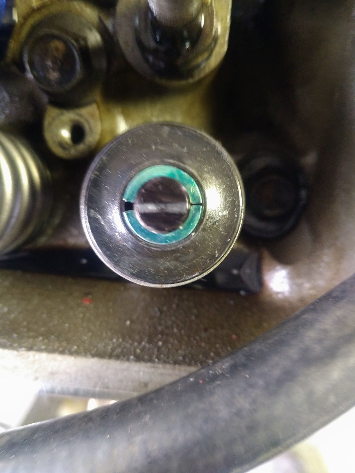

With the cam that I installed, (see cam card photo) and the stock push rod installed I got the following bad pattern, (see photo).

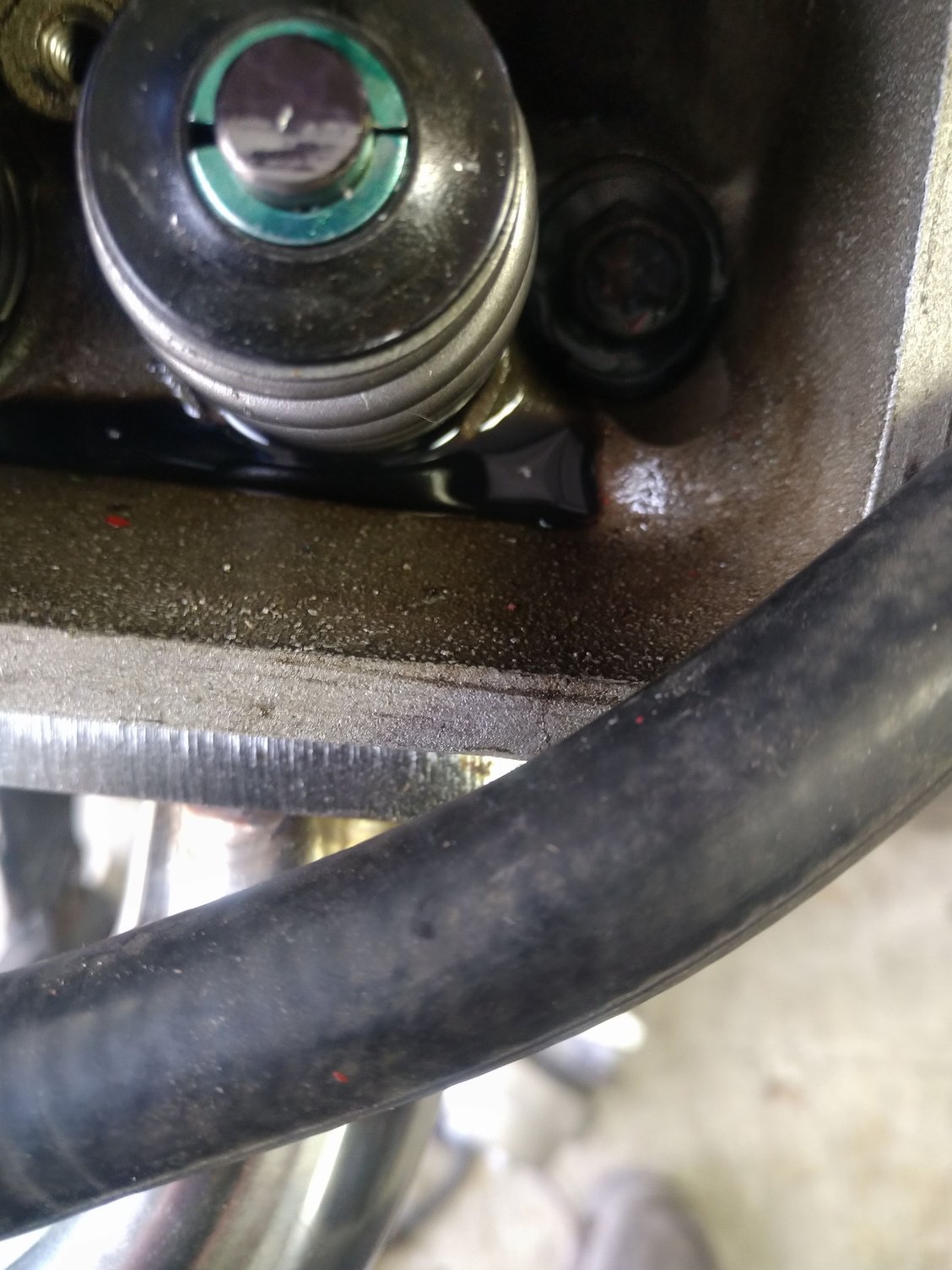

With a push rod length checker I got a good pattern, (see photo).

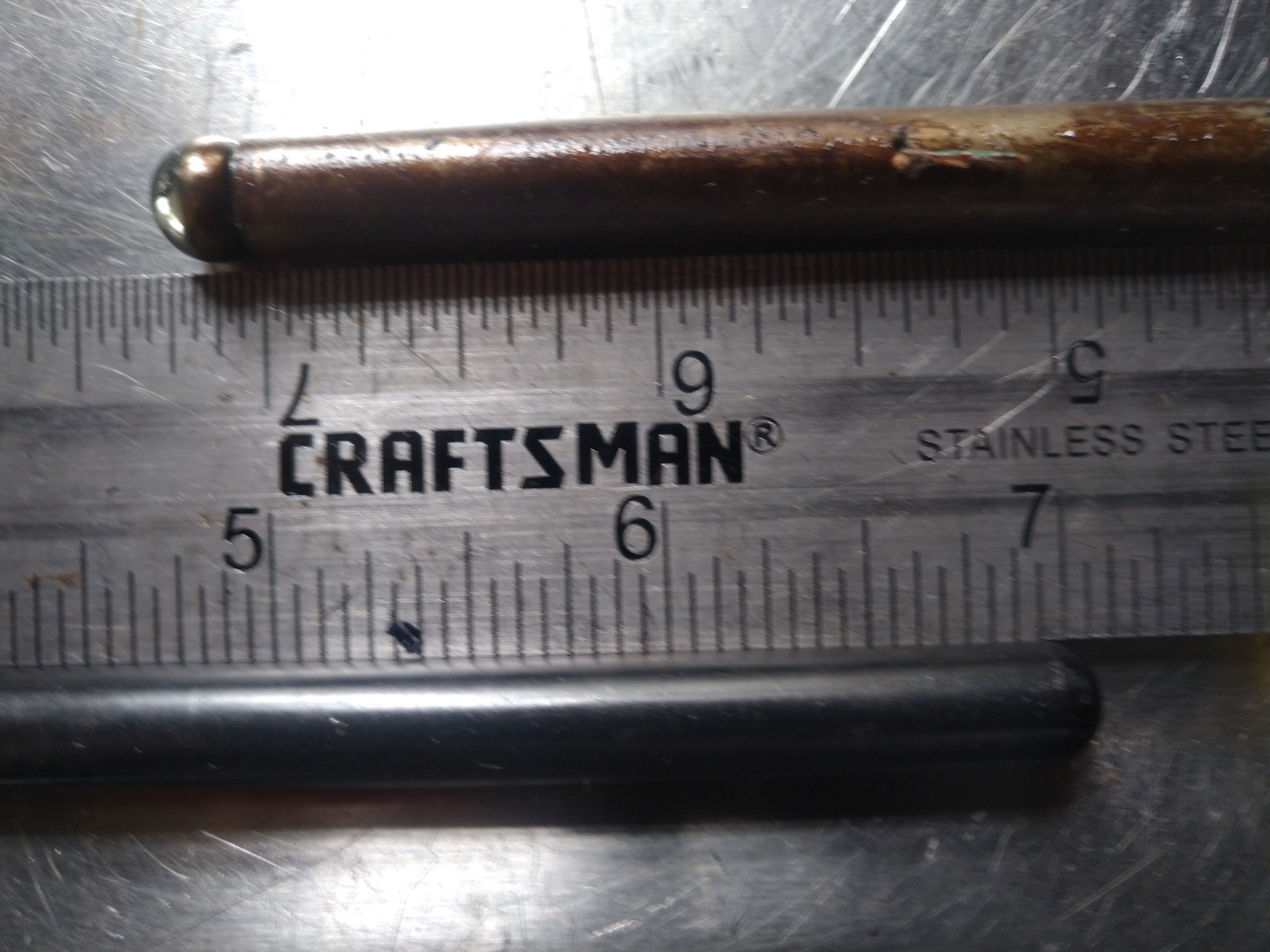

Comparing them on a scale, (see photo) it looks like I need some shorter push rods.

Stock Push Rod Pattern
Push Rod Length Checker Pattern
Top PR Stock Length. Bottom PR length Checker

Looks like I might have to re-measure the stock push rod length...........

It is common with motors that have been rebuild (block decked) and heads refreshed and sometimes using a thinner head gasket than stock a shorter PR is needed to get the geometry correct
Your sweep pattern shows you need a shorter PR. I have the 466 cam and wound up needing a 7.100" PR. Set up your PR check tool at 7.150 and 7.100 and see which one gives you the most centered AND narrowest witness mark pattern and order those PR. I got the thicker, hardened, .080 wall Trick Flo PR as I use guide plates (ISKY)
