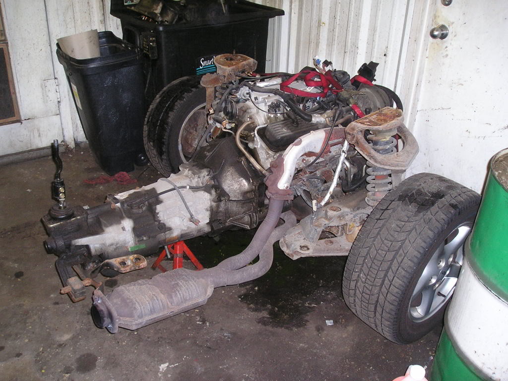

I left the wheels on one, but make sure you put a 4x4 block of wood between the lower control arm and the k-member, so it doesn't drop too far
I should have a pic of one i did like that, one sec
Old Aug 25, 2008 | 03:42 PM
  #26
Dave89IROC's Avatar
Joined: Aug 2002
Posts: 4,676
From: Melvindale, MI, US
here it is

Love the massive oil leak on the back of the engine...I just discovered mine today also.
Good ol LT1 intake manifolds
