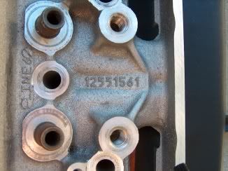

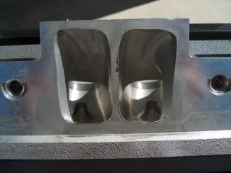

i bought these from another memeber, they look to be ported and polished but maybe not professionally. Do they look like they are still good? And if so do they need work still?

Looks a bit rough and definitely NOT professional. Did you buy them with this understanding?

I've just ported a set of LT1 and had them flow benched. Some of the standard, very basic and easy mods that really picked up my heads look like they've been done OK . Can only tell much from pictures.
To be clear, I'm no expert. I have actually used a flow bech a little and ported numerous sets of heads with what I'd call good performance. From the experience I've had with my most recent set (LT1 heads that were flow tested before and after the porting)_I think you should take a look at the short side radius ( where the intake port floor turns down to meet the valve seat .) If they didn't mess with this very much you'll probably have a nice improvement over stock. Probably not a 280cfm race head but a nice improvement in power across a wide RPM range.
If the short side was totally butchered the head may be hardly any better off than a stocker. could even be worse overall. If someone in your area flow tests them I'd recommend spending a few dollars and getting a couple pairs of ports tested. Then you'd have a much better idea about how they might work and what they might need to fix any weak areas.

Intake ports look kinda funny.

I think they look pretty good! They did a really good job around the valve guides especially, and blending in the valve job. It's hard to tell how high the tops have been raised, what the short-side looks like, and how thin the pushrod pinch point is, though.
Flow them before spending any money.
