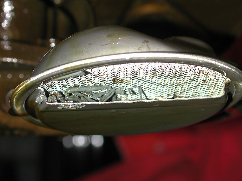

If, for example, someone went ape shiat putting RTV on the pan gasket that then squishes "into" the engine side (or any gasket that is exposed to the interior of the engine) that RTV breaks down and little pieces can (see pic) REALLY affect the oiling system. This is when I stopped letting anyone else work on my motors
