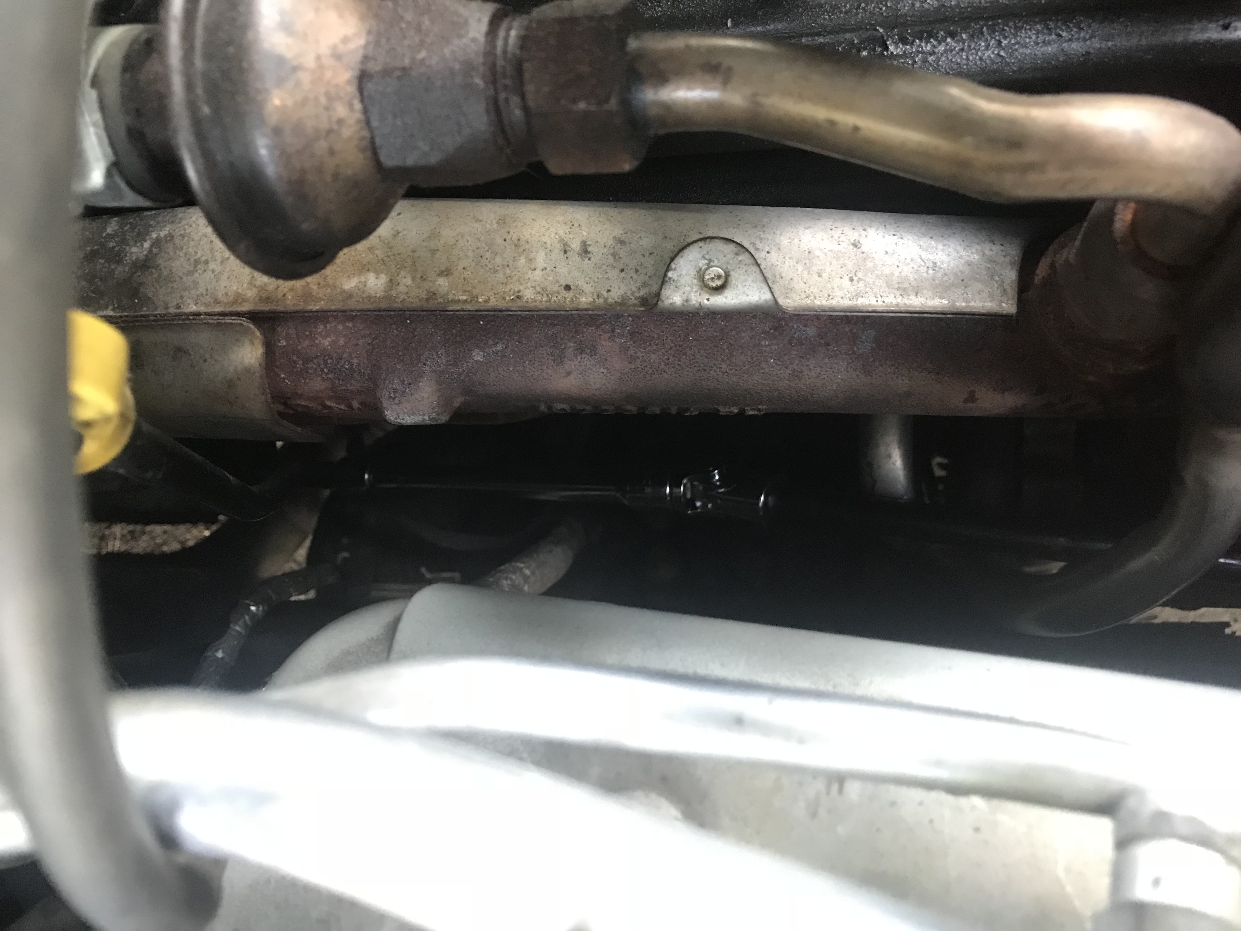

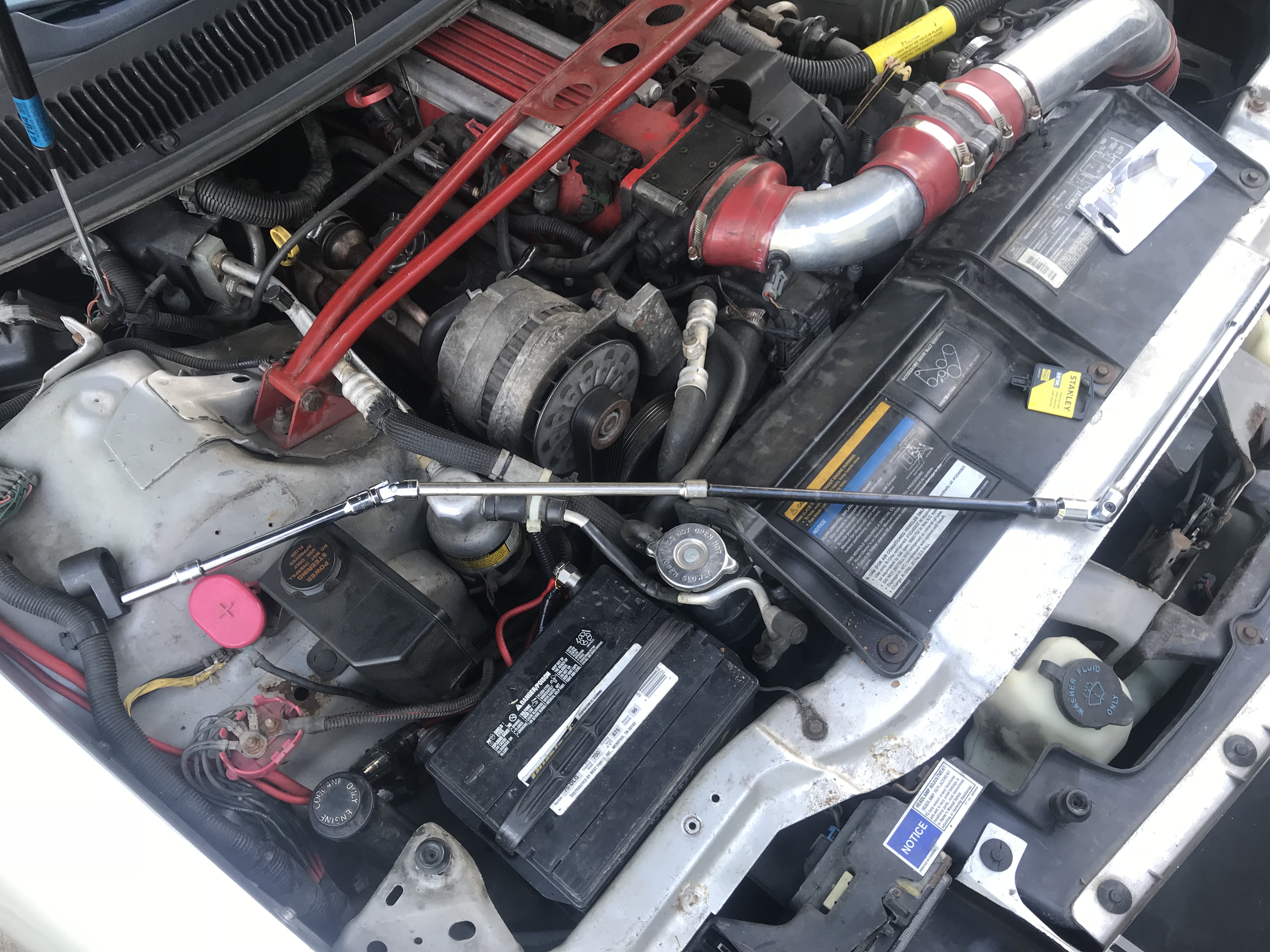

Old Jun 5, 2018 | 06:41 PM
Zaborg95's Avatar
Joined: Jun 2018
Posts: 4
Re: Passenger Side O2 removal
Passenger Side O2 removal-d47db08b-db66-4df7-ab85-c6a93f815d39.jpegPassenger Side O2 removal-431c79df-008b-4fd7-8218-8b09f3f9e7c3.jpeg
Got an o2 socket on it and a breaker bar through about 2 1/2 ft of extensions and a u joint. It’s in there so tight it spread the socket.

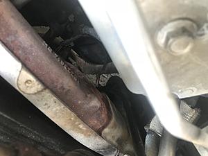

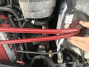

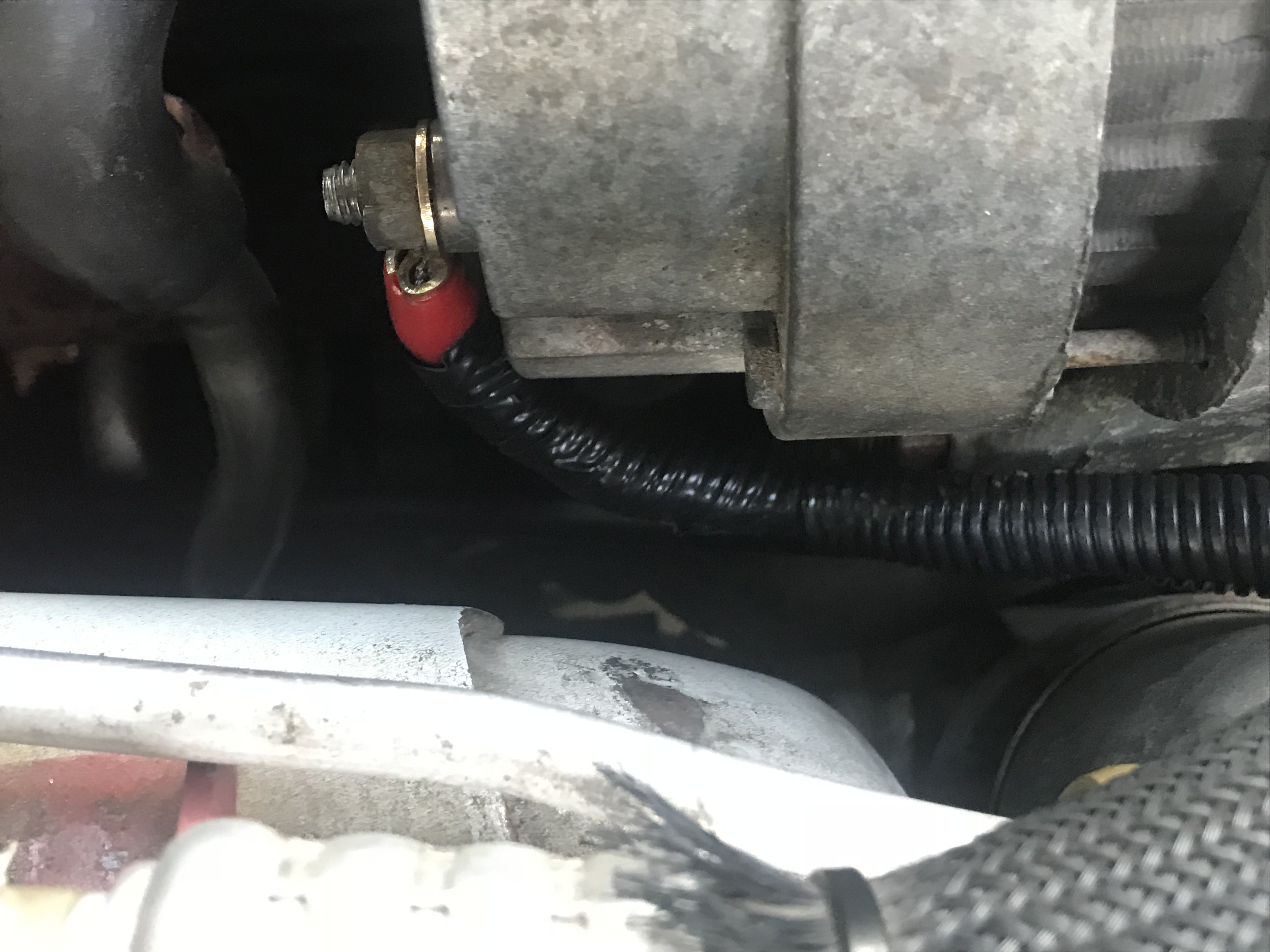

Old Jun 5, 2018 | 07:05 PM
Zaborg95's Avatar
Joined: Jun 2018
Posts: 4
Passenger Side O2 removal-e40d1215-9cc1-47bc-b2e0-dd7106477f89.jpegPassenger Side O2 removal-5df253e1-4964-49dd-afcf-906687cbe675.jpegPassenger Side O2 removal-67f8e517-e1a2-4257-81b0-46192a5b31de.jpegPassenger Side O2 removal-1f118ccf-05e2-4fec-808a-2d7ce4977c74.jpeg
Just Incase anyone else comes across this problem, this worked for me
