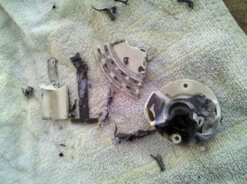

Well my shoulder finally started feeling better, so i decided to tear my opti off. I got it of and shook it and heard rattling. I took it apart to find the rotor in pieces. The weird thing was the middle of the rotor was still screwed down but half melted. The rest of it was in tiny pieces. I'm guessing that it was melted due to the coil still firing and arching all over inside the opti. Do you think the rotor would have just fell apart or could my msd 6al have melted it?

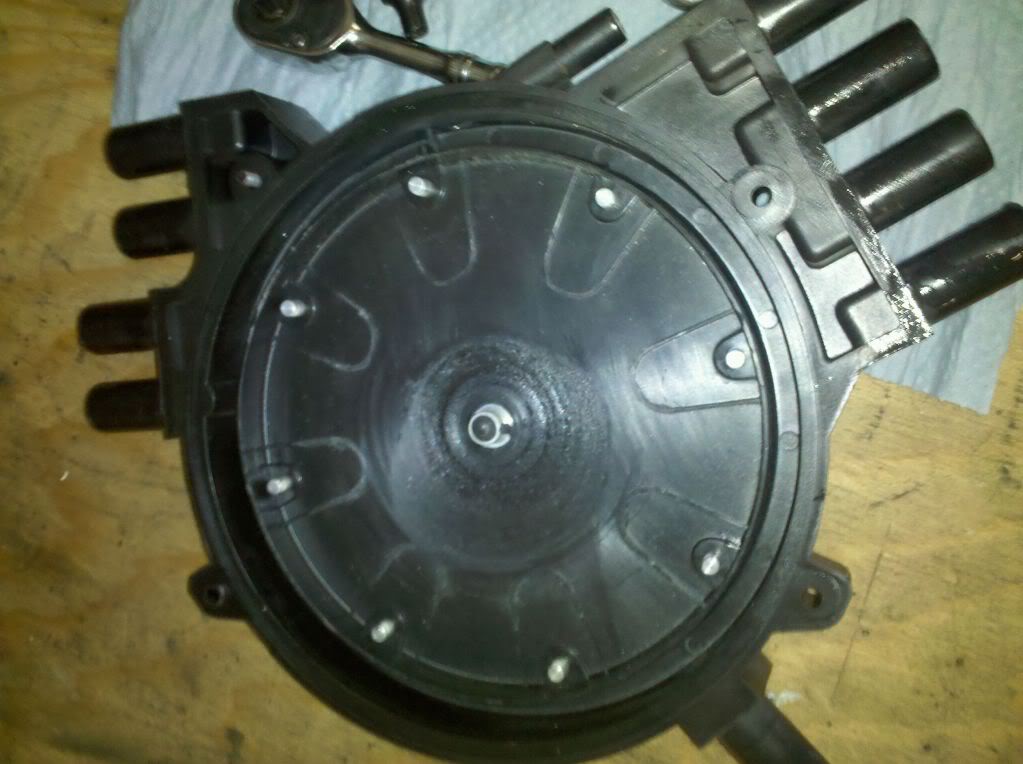

Ive got the opti apart and its another blown rotor...although its not in near as bad of shape as the one above. I got an email from somebody asking if I have the vents properly hooked up. All I have is two vacuum hoses hooked up without the check valves as they previous owner didn't have any vents hooked up at all. Could this be a problem? What is a good vendor that sells the vent hoses with check valves?
pics

Is it me or does it look like there is a lot of melted plastic going on in there?
Old Aug 21, 2010 | 10:50 PM
Jameslt1TA's Avatar
Joined: Sep 2004
Posts: 1,152
From: Wyoming
Cool
I think that is due to me cranking it over trying to get it to start. The coil is still working and arching all over inside the cap. Either that or the turbo is getting it hot(about 5 in. or so from the turbo). I'm going to put heat tape on it(opti).
