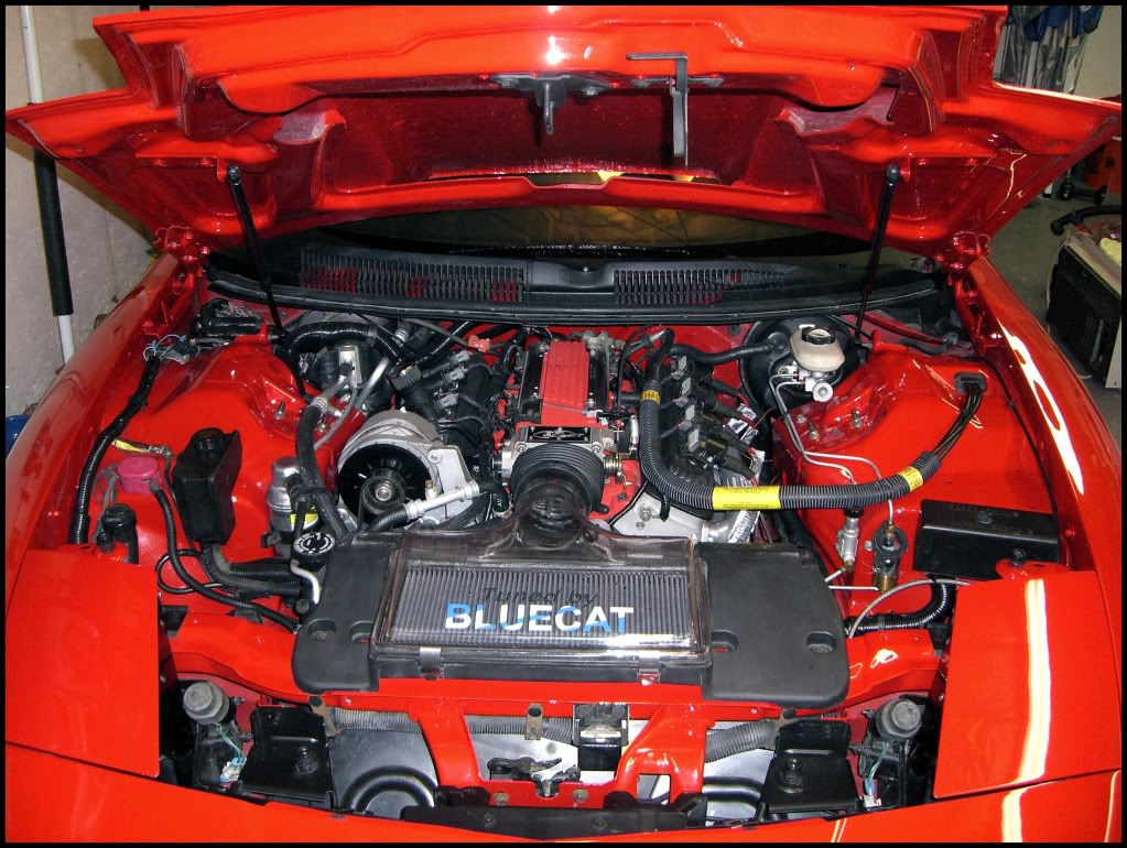

Only part I got off them was whats in the pics. I made my own harness. Got my own coils and pcm. If you don't have spare harness laying around their little wiring kit is a pretty good deal.
Old Jul 27, 2010 | 10:57 PM
  #40
funina91ss's Avatar
Joined: Apr 2001
Posts: 1,331
From: Huntington,WV
Updated pic

Ok Im sorry if I missed this in the thread, but did you just "re-pin" the original harness to the LS1 PCM connectors? I assume the only things you really had to change were the Opti wires and the CPS? I am curious because I have a 96' LT1 swapped into my C10 and it would be fairly easy for me to just change to LS1 connectors and swap to the 24X system. I suppose you also have the harness for the coil packs, but whatelse did you have to mod from the factory harness?? Sorry for all the questions, I am fairly new to all this....
Old Aug 2, 2010 | 08:11 AM
  #42
funina91ss's Avatar
Joined: Apr 2001
Posts: 1,331
From: Huntington,WV
We hard wired in the coils in. Had to run a few extra wires in the harness for cam and crank sensor but other than that it's just swapping out pins and putting them in the right place. Nothing major is you have the pin diagram laying right in front of you.
