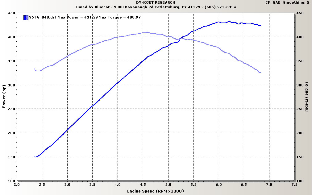

Old Jul 27, 2010 | 11:01 AM
  #30
funina91ss's Avatar
Joined: Apr 2001
Posts: 1,331
From: Huntington,WV
Specs 383 12.2:1 AI 200cc CNC Ported Stock heads. AI speced custom grind cam. EFI conections 24X LS1 pcm conversion, 4L80E w/edge 3600 stall,10 bolt 3.23 gear.
With the normal bolt on's. Thats going threw the full exhaust with a borla cat back opened on the Rt side.
Just got to thank Phil for all his help in getting my car to where it is today. Hopefully by this fall it will be making over 600 rwhp.
Here is the graph. NA on 93.
