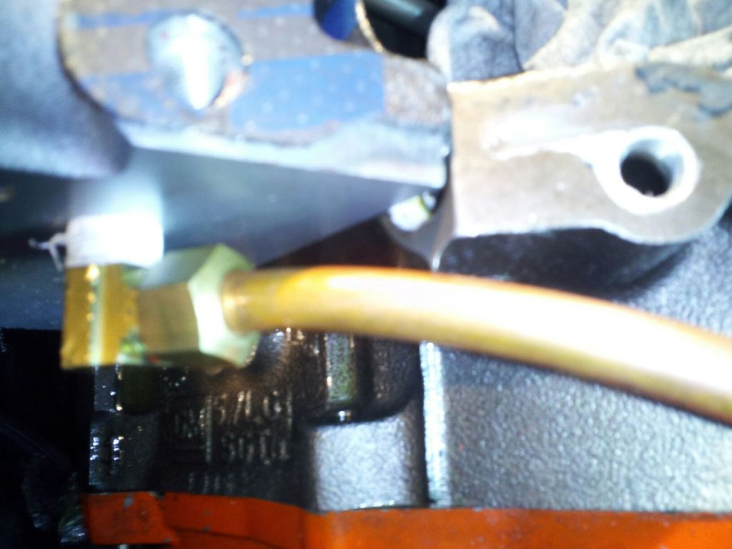

yes yes yes, checked everything. i found it, on the top of the block , a few inches to the right of the oil pressure sensor there is another hole(not sure what its for) it is plugged, and i guess the plug is just leaking. got a mirror and had someone crank the motor and watched it fill up and run all down the side of my block
the hole that is half covered by the head

I think that is where the check ball is, I read about it in a rebuild book on the LT1. Not sure why it would leak though....

That's a hole where the oil passage was drilled, it sucks when it leaks, but yeah, head has to come off, its a threaded plug
what caused it to leak? its a fresh rebuild, all new plugs and what can i do to prevent it from ever happening again?

Usually, it leaks if it wasn't sealed and/or tightened.
Or, I recall once having a similar problem with a 1/4" pipe plug that had a .030" hole drilled through the center. I didn't notice the hole, put it in that same spot under the head, torqued the head and found the leak when I primed the motor. It was supposed to go in an oil galley front of the motor behind the timing chain to spray oil on the chain during operation. I don't even know when that kind of plug was put into production motors but if it gets installed in another spot in the car, it's an instant problem.

That part of the galley serves no purpose but it has to be drilled there so that it connects two passages lower in the block. No one has, to the best of my knowledge, devised a way to drill a hole with two blind ends. The solution is to drill the hole where it has to be, plug the end, and let the unwary end user find out the hard way. You'll know to mention it next time.
Was the problem that the plug was left out, simply not tightened, or was it a drilled plug?

The plug was left out
