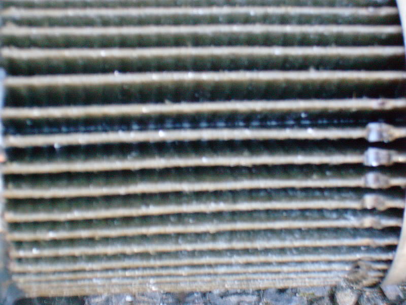

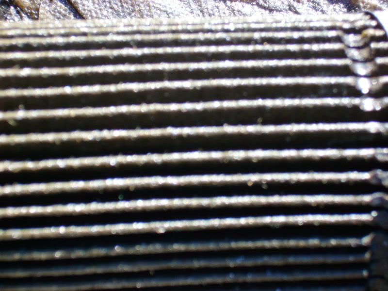

Well I drained the oil this morning and cut open the filter. I'm afraid I think i've spun a bearing. I didn't screen the oil but it appears there isn't any metal filings in there although it does have a silverish tint to it. Cut open the filter and they are very hard to see but there are a good amount of microscopic like metal peices in the filter.
Now does this indicate the bearings spun in the crank or could it also be from the cam? Are there any other ways of making sure it is definetly a spun bearing besides ripping apart the engine?
Here are some pics, camera sucks so quality isn't good not sure if you can really see the metal peices:

I've seen a lot worse in the filter although it looks to me as if something is in the process of eating itself. It won't get better with age.
The shiny pieces (non-magnetic) are the surface material of the bearing. The copper-colored bits are a part of the bearing backing material. Any fragments that are attracted to a magnet are from the rods, the crank, or the block. There is a possibility that it could be the cam but it really doesn't make much difference. If you drive it, the problem will get worse until it unravels completely. If you take it apart now, you may be able to avoid some more extensive (expensive) fixes.

The next step is up to you. I think that it would be prudent to take the opened filter to a reputable machine shop and have a knowledgeable person evaluate the situation. That would be better than relying on someone 3000 miles away looking at a fuzzy picture.

i have to agree that you spun a bearing. Maintaining a high-rpm for a long duration of time while the engine doesnt have much of a load, or any load is not good and will definitely test your bearings out.
I think if you had messed the cam up it would probably have become apparent well before you did the long burnout.
