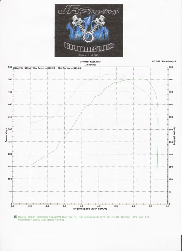

I have been to the track quite a few times lately and the car kept getting faster so i decided to dyno it also
the car is a stock headed 355, stock compression with a 503 cam with full bolt ons
there is only and 1/8 mile track around but the car went
on motor: 7.79 at 93 mph with a 1.8 60'
on spray(125 shot): 7.32 at 102 mph with a 1.78 60'
here are the dynos
on motor
on 125 shot

Nice mph N/A and on the spray. That small cam is making good hp! What raceweight ? I assume you are running a 6 speed by the dyno graphs.

Looks like from the charts, you have valve float. The power falls off the cliff @ 5900 RPM. That cam should pull well over 6K RPM. I have been down this road. Better look into it.
Definitely a strong motor.

my stock heads cc503 motor was still making power @6400rpm
