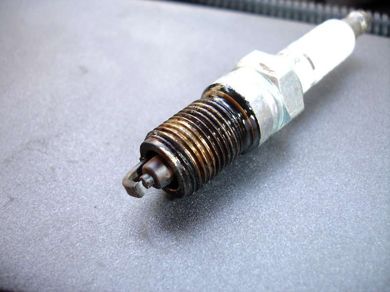

I have been fighting a low idle hesitation with my 95 LT1. This motor sat for awhile until I got it installed in my project vehicle. Since then it has been a small battle trying to get everything tuned in properly. I had 4 stuck injectors. Then I had 4 that wouldn't shut. So I replaced them all. After the injectors I installed new OTVC MSD wires and NGK TR55 plugs. I have some valve train noise and it sounds like I need to set everything back to zero lash.
However, tonight I tore my intake off for a clean up and a complete rebuild. It was horrible. This motor had some serious blow by. I pulled the PCV valve and it was nasty so I replaced it along with the rubber fittings. I cleaned up the TB and all the sensors hooked up to it. So I decided to replace my plugs again since I had the bad injectors and everything was pretty bad.
I always start at the back of the block and as I worked my way towards #1 I noticed the plugs started getting dirtier. #5,7,4, and 8 were all in good shape. However #1 and #2 were really bad. #3 and #4 weren't as bad but were still pretty dirty. Yesterday I ran some Gunk Motor Flush in my motor to help clear stuff out and replaced my oil with Mobil 1 5w-30 and a quart of Lucas Oil Stabilizer. The substance on the plugs look exactly like that what I cleaned out of the intake and throttle body today. I don't understand why it is so high up on the threads though. On with the pic. This plug has less than 2 hours of run time since new.
any suggestions would be greatly appreciated. My motor is running real smooth now. I have no smoke out the tail pipe. Idle is almost 100% and is getting better since I cleaned out the TB. The IAC was just caked.

With even the tapered seats oily, I suspect the plugs were not perfectly sealed. Make sure there is no crud on the seat around the thread holes in the heads when you reinstall. Just a guess, though.
Nope. This has to be coming from inside. There is no sign of anything from the valve cover at all. The gaskets are new. I'm thinking I need to replace the valve seals and just freshen up my top end.
