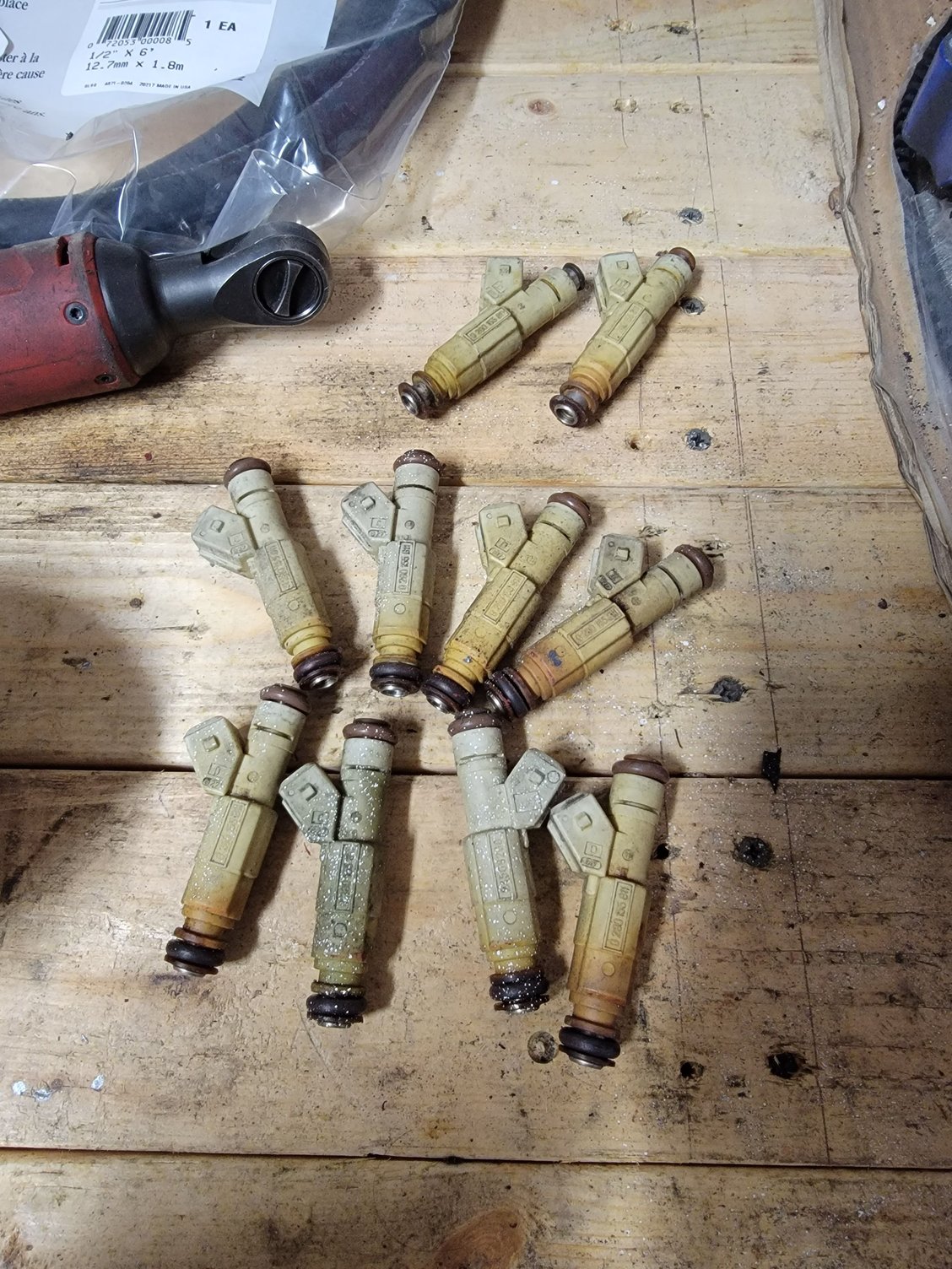

I have a set of 36# injectors i was running on a 400hp car. If you're interested let me know. I'm procharged with 60# now so i have no use for them.

Would u share the brand/part number and how much you are asking? thx
They are delphi stock GM injectors that i to off of a grand prix. I'll sell for $125 shipped. I'll throw in 2 extra, total of 10 injectors.

I got my 60# from TRE based on recommendation from Moe Bailey. I think they are remanufactured Bosch by TRE but I'm not sure. Either way, I have had no issue with them and I would feel confident in getting them if I were you.
I mis-spoke earlier - the 36# injectors i have are Bosch, not delphi.
