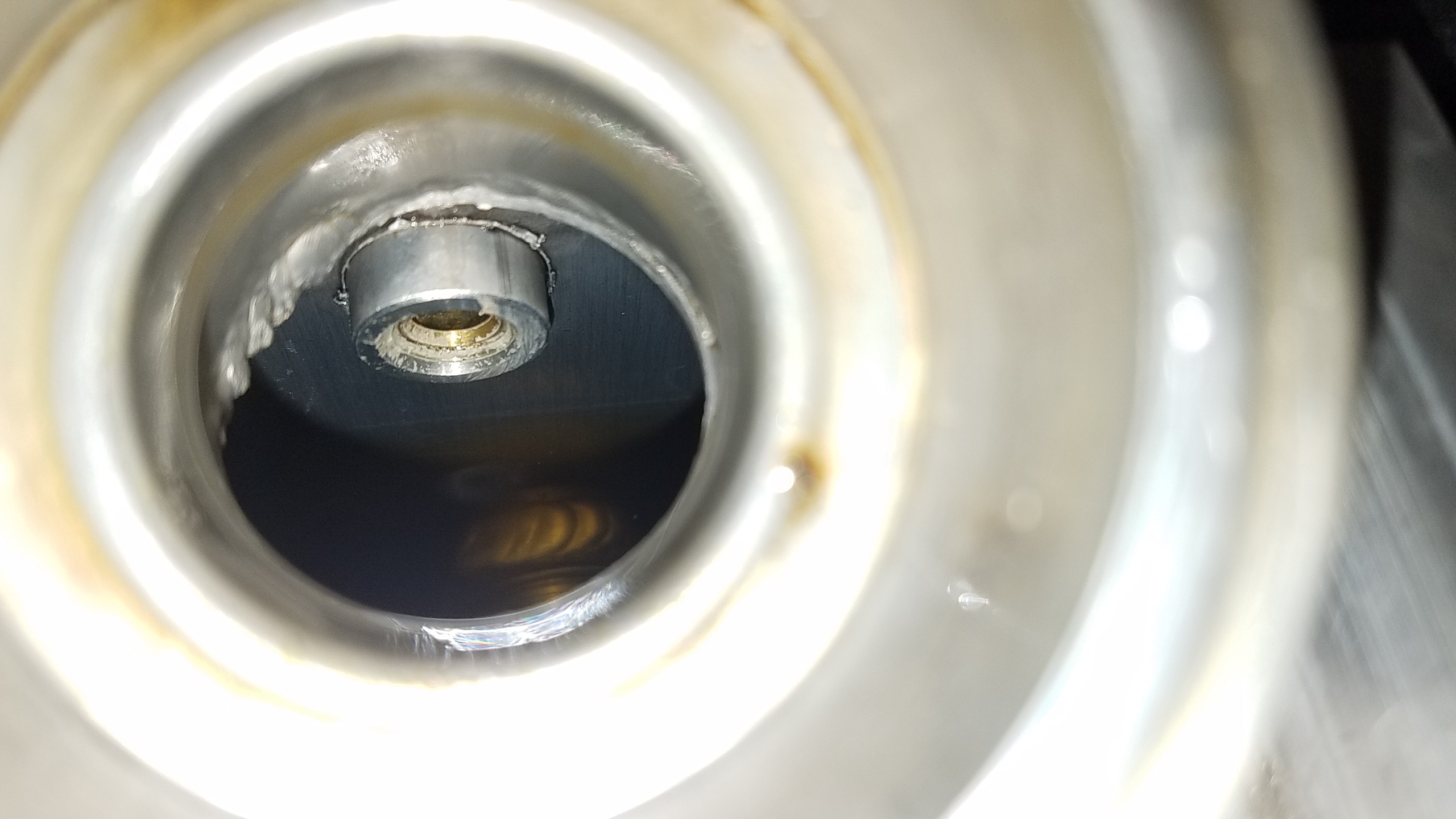

As you can see/hear in the videos, I'm getting some really loud popping after the car gets up to temp. The smoke that you see seems to have gone away after I added a bottle of K-Seal to the coolant, so I must have had an an internal coolant leak. I can't seem to find a place that wants to even do testing on this car. The motor only has about 500 miles on it, but time-wise, I can't take it back to the builder. Also, regarding the coolant, I see everyone says to fill it up to the top of the neck, but if I do that, when I start it up, it immediately starts pushing out (pic attached of where the level seems to settle after running). I'm also seeing steam out of the radiator cap. For reference, I'm running Evan's NPG, so the cap low pressure cap (if that makes any diff).
What do you guys think? Am I screwed? Do I just need to pull the heads? If so, is there any way to know which head I should pull since it's such a pain? Or does it seem bad enough I need to pull the whole motor?

I don't think the coolant itself is much of the issue. I'm more concerned with the popping (is that considered backfiring or a miss?) But the coolant being pushed out on start up is the coolant system being pressurized? Do I need to pull the heads? Any way to determine which one if so?
