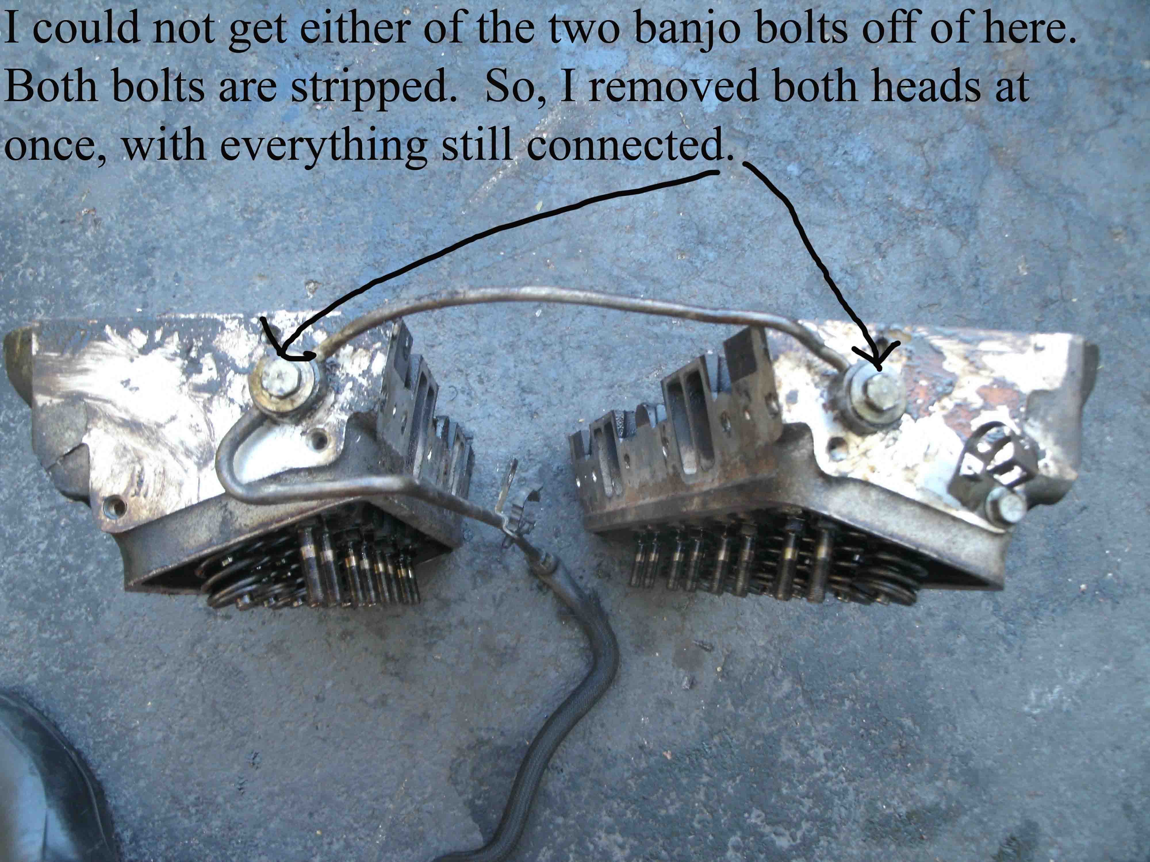

Fatdog2 - I actually used a hose on low pressure to flush the heater core (instructions on shoebox's website) In retrospect, I wish I had used something like prestone to flush the entire system because I fear the gunk being stirred up may have caused my head gasket issue.

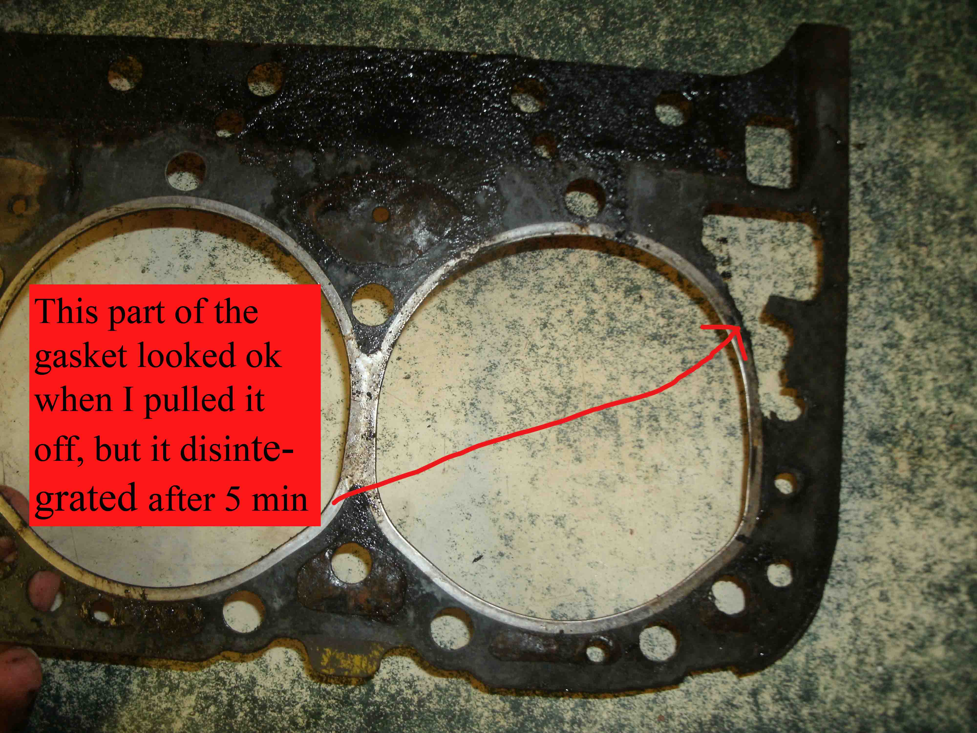

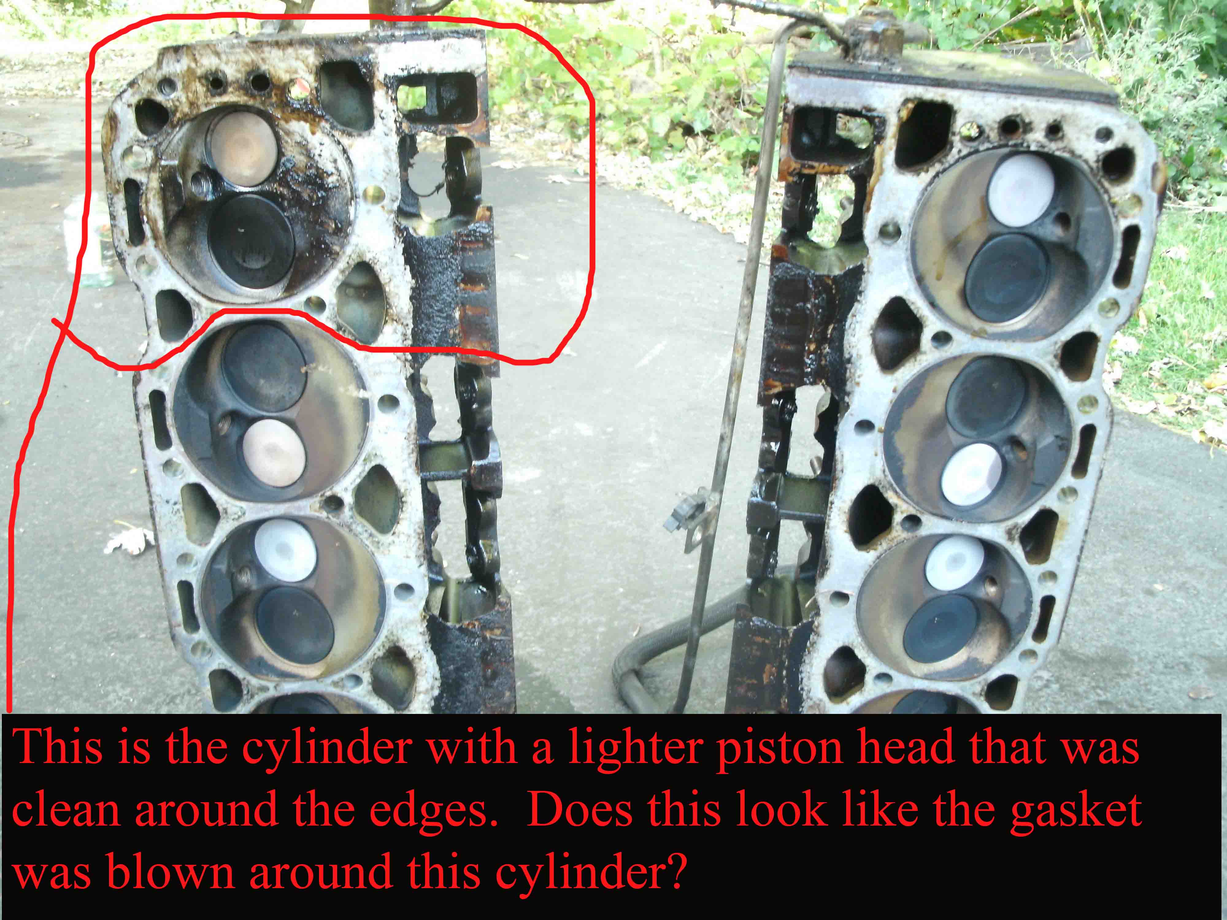

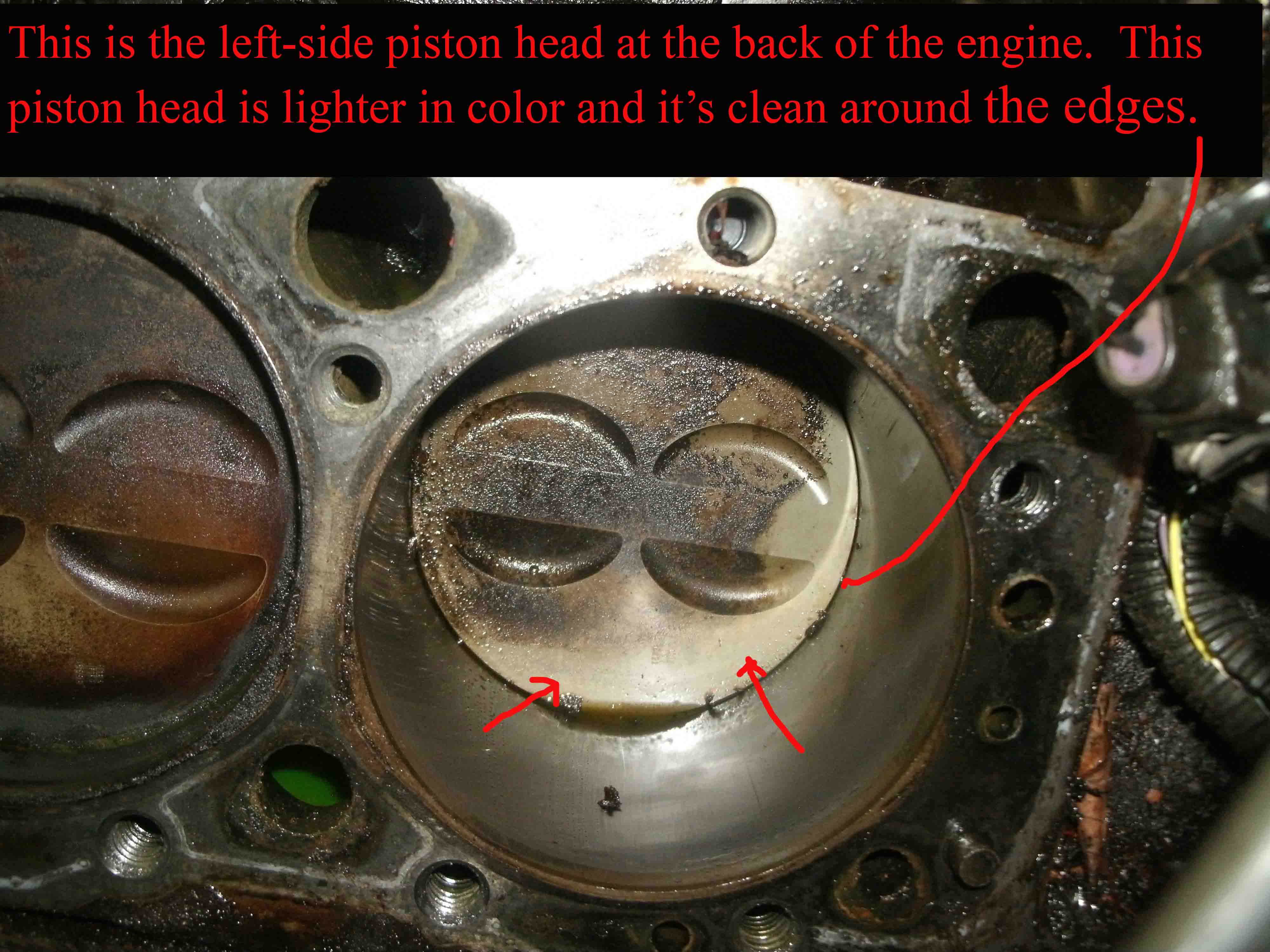

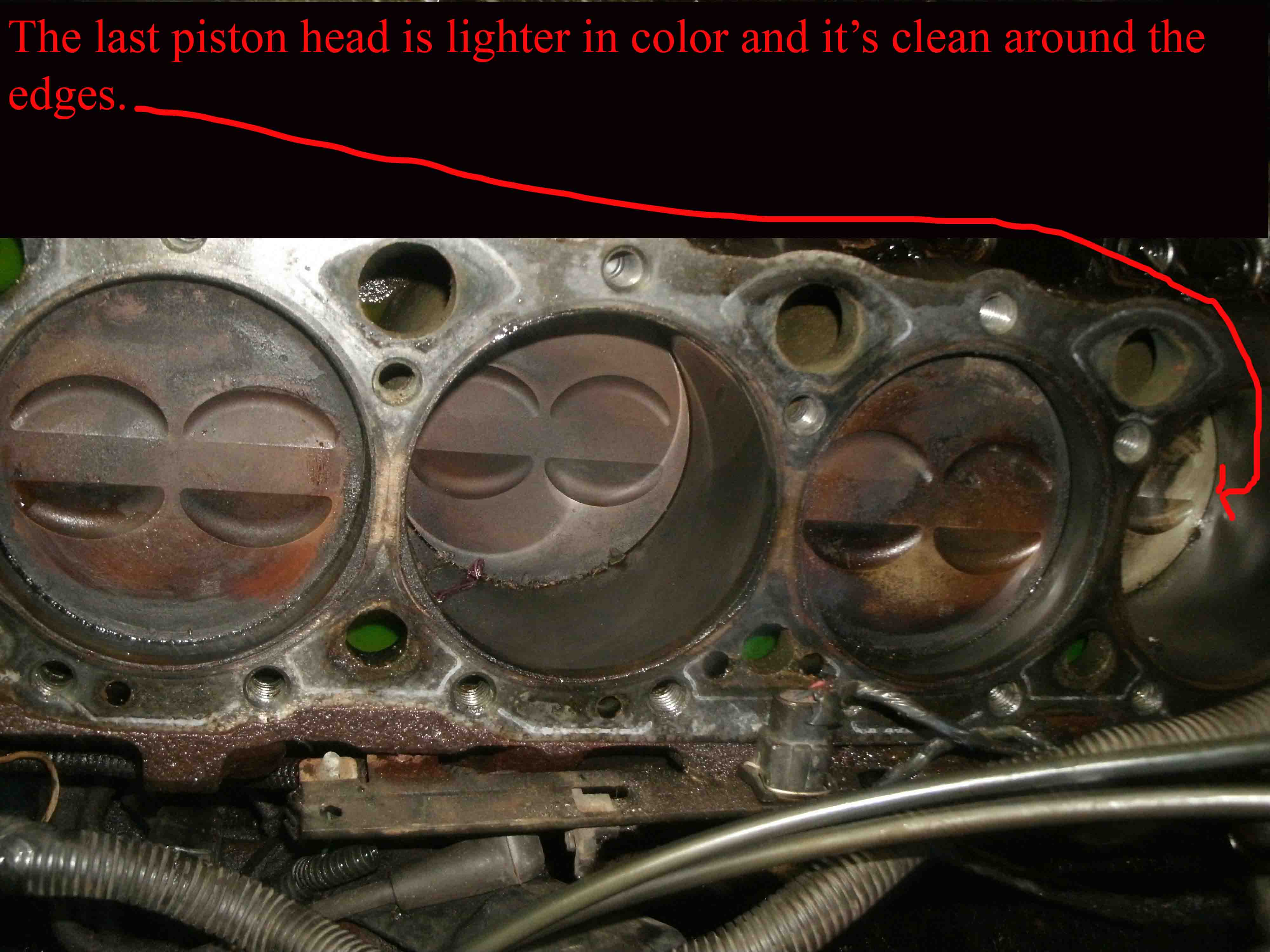

This weekend I removed both heads. I am hoping for some feedback from the forum's members as to whether these photos depict a blown head gasket. I've never done this job before, so I'm not exactly sure what to look for. It seems to me that the left-side rear cylinder "piston head" appeared lighter in color, as compared to the other three "piston heads" on that side (it was also clean around the edges). See photos. Although the gasket was intact when I pulled it off, once it dried out, a portion of it broke off when I started taking photos (see photos). I don't see any obvious cracks in the heads and I'll clean them up tomorrow.
I have to tell you that removing these heads made me feel like I've been to hell and back. I'm concerned that I did not document precisely where the hoses on and around the intake manifold/fuel rail all go, so I may be asking for some more help from the forum's members on their proper placement once I hook everything back up.

From what I can tell looks like leakage on the exhaust side at the back cylinder. The other side looks like it might not have been far from the same fate (looking at the head picture). The clean cylinder is definitely the telltale for leakage.
Doing the flush would not cause this. This is a long term gasket breakdown.

You could use the later steam pipe, but you might need a little longer rubber hose to connect it to the radiator. Did you get the pipe off and see that it and the banjo bolts and head are not clogged? If they were clogged, it might contribute to more heat at the back of the head and deterioration of the gasket in that area.
