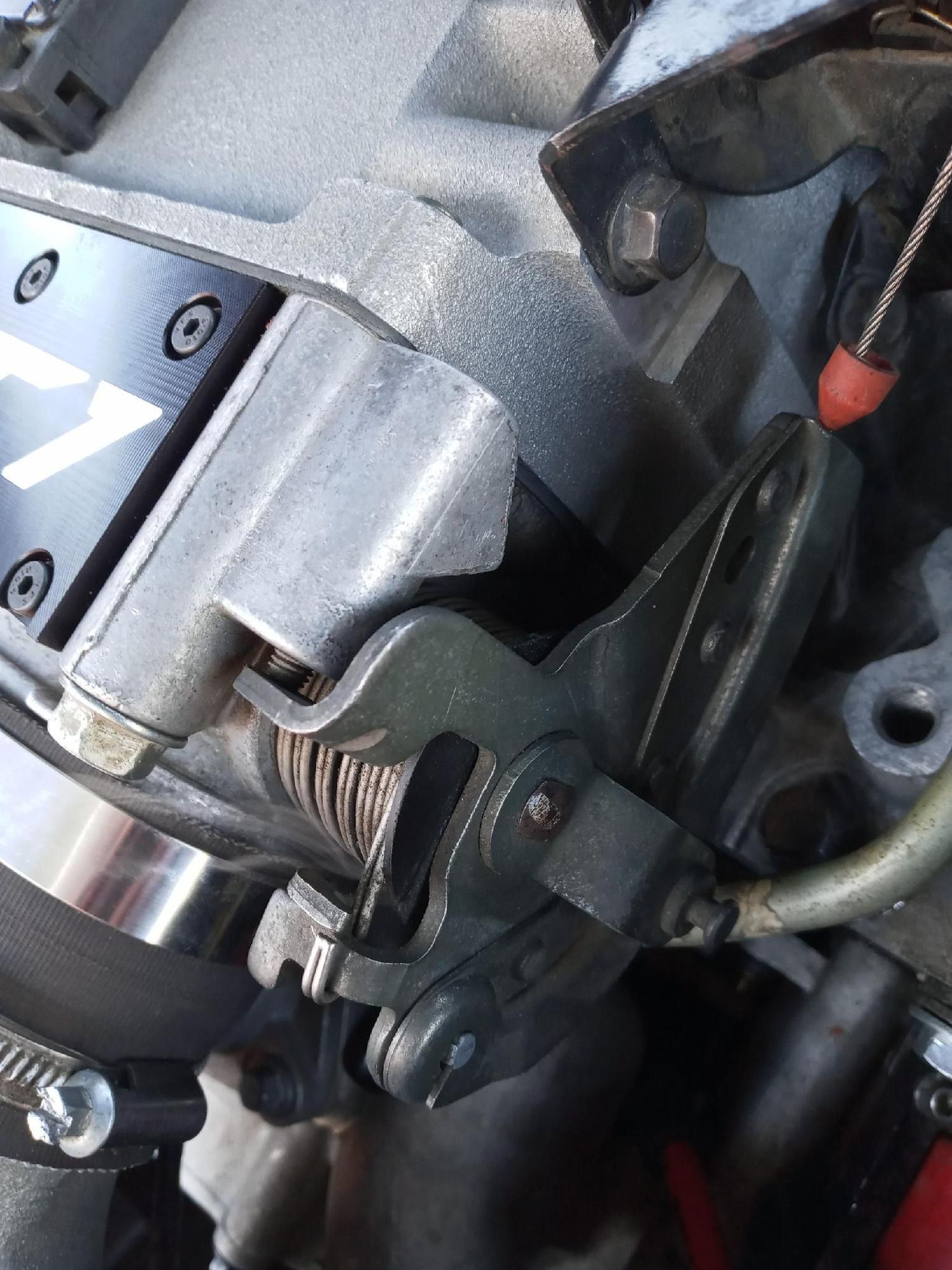

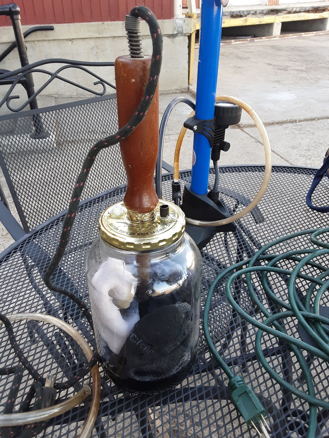

Over the weekend I built a smoke machine that I saw on youtube, best $11 ever spent. Works phenomenally well. Used it to try and find vaccum leaks and I couldn't find any but a slight weird one. No leaks from any vacuum lines, injector o-rings, intake manifold gasket, brake booster etc.. I've attached a photo of where smoke is coming from what seems to be behind the throttle springs, not the throttle body gasket, actually behind the springs themselves. That and a small amount from the cracked IAT rubber seal that I previously posted a picture of. I built up quite a bit of pressure to see it come from the springs. I'm going to drive the car a bit and see if the PCM has re-learmed any of LTFC's, may datalog at the same time.
YouTube Link to DIY Smoke Machine:

The TB leak would be the shaft seal, and I have no idea if it is a real seal or just a tight fit of the shaft to the bushing. On the other end, with the TPS sensor, there is a replaceable foam seal around the shaft. But maybe the shaft is seriously worn and the gap has increased. The leak at the IAT sensor is not really a vacuum leak. But it is air bypassing the MAF sensor and could cause a need to increase fuel flow using the LTFT's. But again, there is not a lot of negative pressure (vacuum) in front of the throttle blades.
I can't see either of those being a large enough leak causing a 19% fuel short fall, and only on one bank.

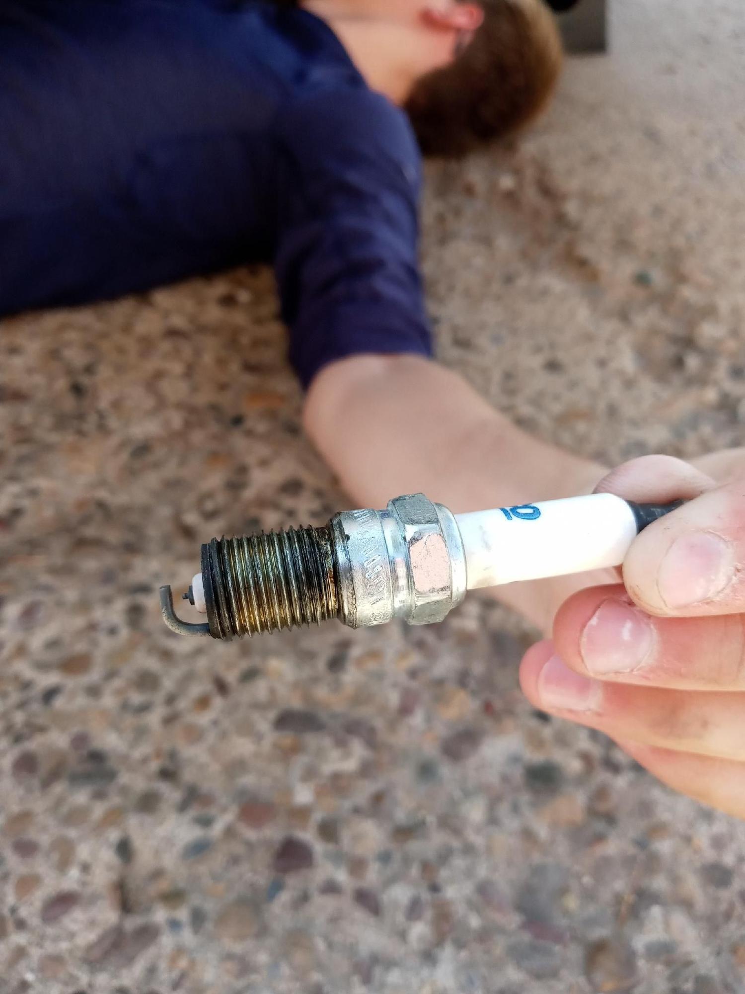

Verified gap on current spark plugs and took a few pictures. All gapped at 0.05in. Plug wires are almost brand new MSD 8.5mm, not crispy at all.

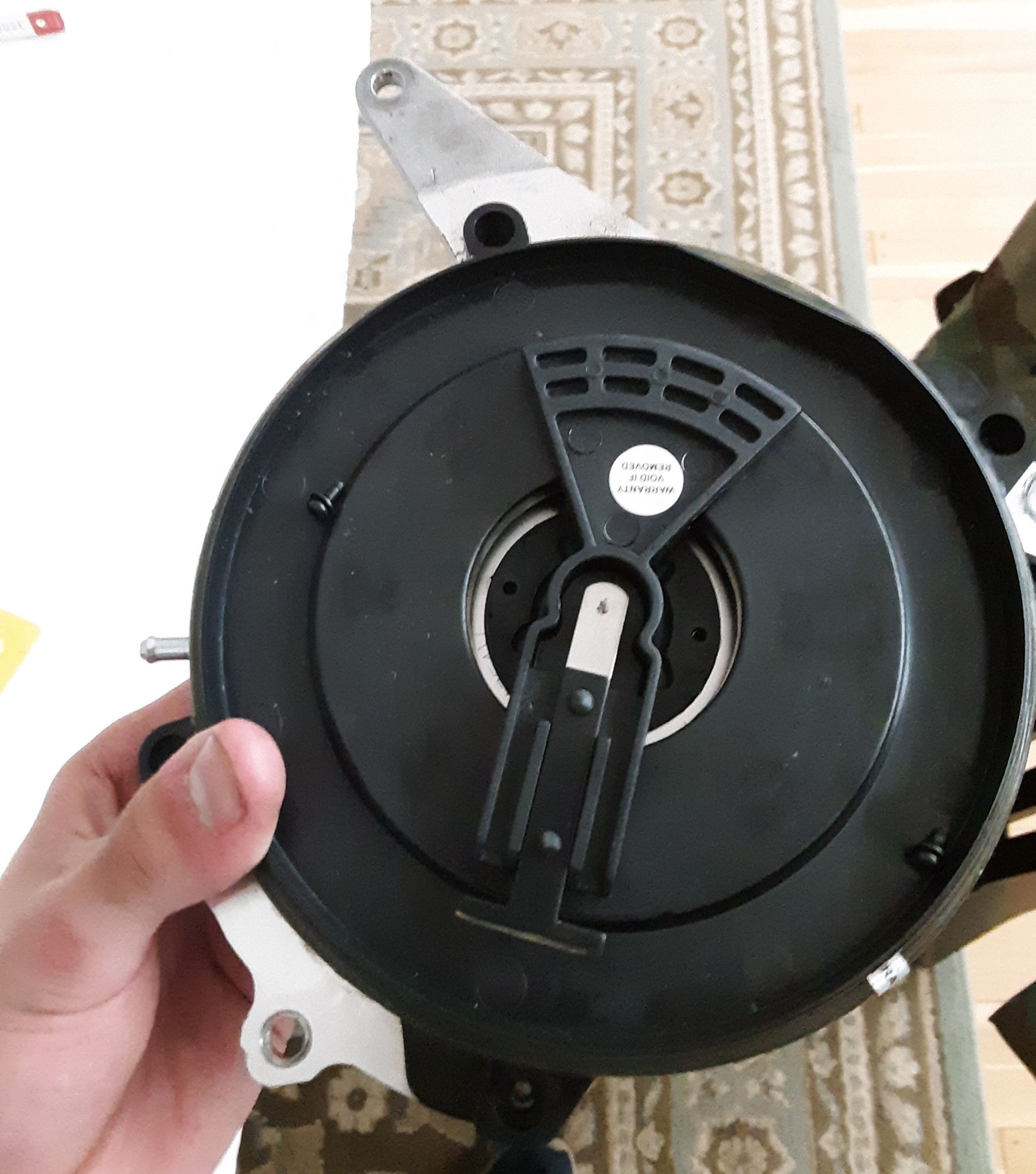

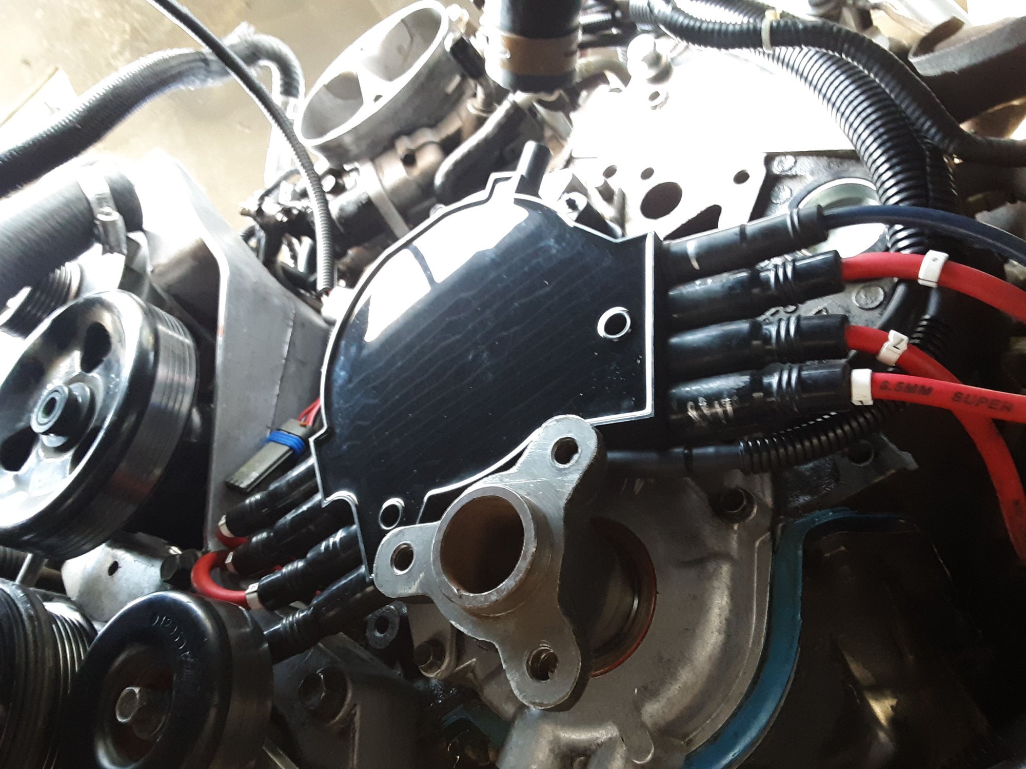

Current update, after not finding any weaknesses in the fuel system, not finding any exhaust leaks or vacuum leaks, and all other tests performed up above, I decided it was possible the car had constantly varying fuel trims due to a slight misfire from the Carquest opti spark in the car. I decided to invest in a Petris Optispark since I figured it was only a matter of time before the Carquest took a dump or caused other possible issues that would cause me to chase my tail. I wasn't wrong, I removed the Carquest opti and immediately noticed several things wrong once I popped it open (other than the immediate sound of something loose inside). The two screws in the picture below had completely backed out and were just laying as pictured. Another thing was that it appeared as though the slotted metal disk (unsure of correct name) actually had enough play to contact the optical sensor and had scraps and marring across the surface. This may have been due to the two small screws backing out first. My Petris opti is installed now and the car has a noticeably smoother idle. I haven't had time to really beat on it, but I would bet it feels a bit stronger as well. In the process of taking everything apart, I re-installed my factory coil (Had an MSD Before) and cleaned all the old thermal paste off the ICM and re-applied some. Moral of the story, don't cheap out on an optispark, this is the second Carquest one that had failed within less than 300mi. I'm not even going to try and warranty it, I wouldn't go to the labor of installing and removing it just to have to pull it out after 300 odd miles. It is now a paper weight on my desk. I'll have to drive the car for a bit, then I'll check the LTFC's. The previous tune is also looking slightly suspect at this point, I have no definite knowledge of who tuned the car however.

Pictures of the metal wheel
