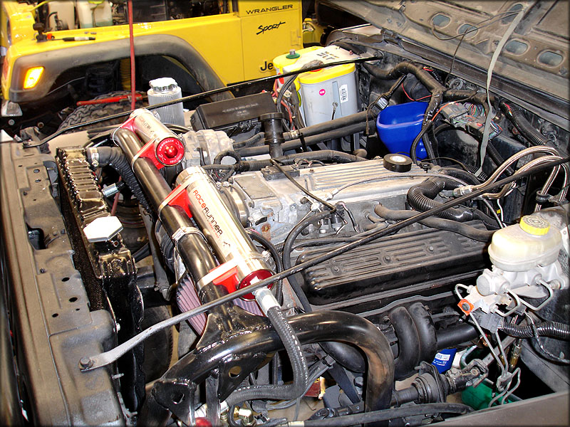

Here is a picture of the unfinished product. I still have tons of clean up to do under the engine bay.
