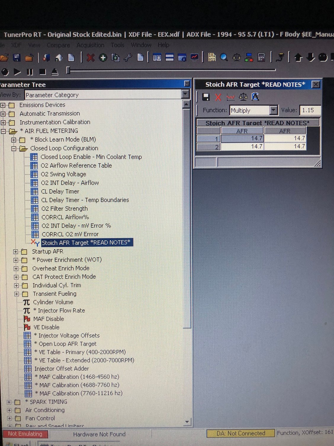

Do you think by changing Stoich AFR Target in tuner pro rt from 14.7 to 14.0 ill have a richer fueling overall? Is that the setting im looking for an overall richer condition?
Old Mar 16, 2020 | 06:07 PM
Posts: 71,103
Re: Lt1 tuning help
I have no idea. I don’t tune the stock PCM. I ditched mine 20 years ago and went with an aftermarket engine management system.
It will be a mistake to start making random changes to the tune without looking at a data log.
