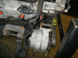

Old Aug 13, 2014 | 09:49 PM
4586's Avatar
Joined: Oct 2004
Posts: 211
From: Champlain, NY
Re: LT1 No PCV valve ?
The engine is going in a streetrod...have the alternator mocked up "down low"...should make it easier to locate valve covers.
