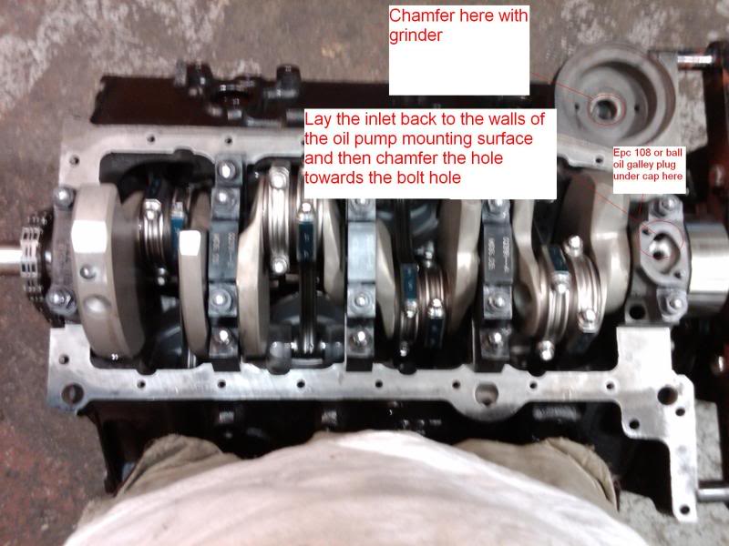

he spoke about removing a plug near the oil filter area and running a line to the front of the block fot better oiling. He also mentioned about the oil restrictors and enlarging/cleaning up the oil drain back. He also touched on putting screens in the oil drainback incase a lifter broke and debris wouldn't enter the oil pan.
i've never seen that one... but maybe he knows something i don't... the tricks i was talking about are very simple and work well... 1. enlarging and cleaning up the oil drains 2. chamfering the oil filter hole and 3. enlarging and smoothing out the oil inlet on the rear main cap under the oil pump
the screens are a good idea
[I'm currently looking at running the Milodon high pressure pump and pickup with the 30909 Milodon 6 quart pan. I'm not sure if the extra 10psi you speak of would be beneficial with a SR setup..[/QUOTE]

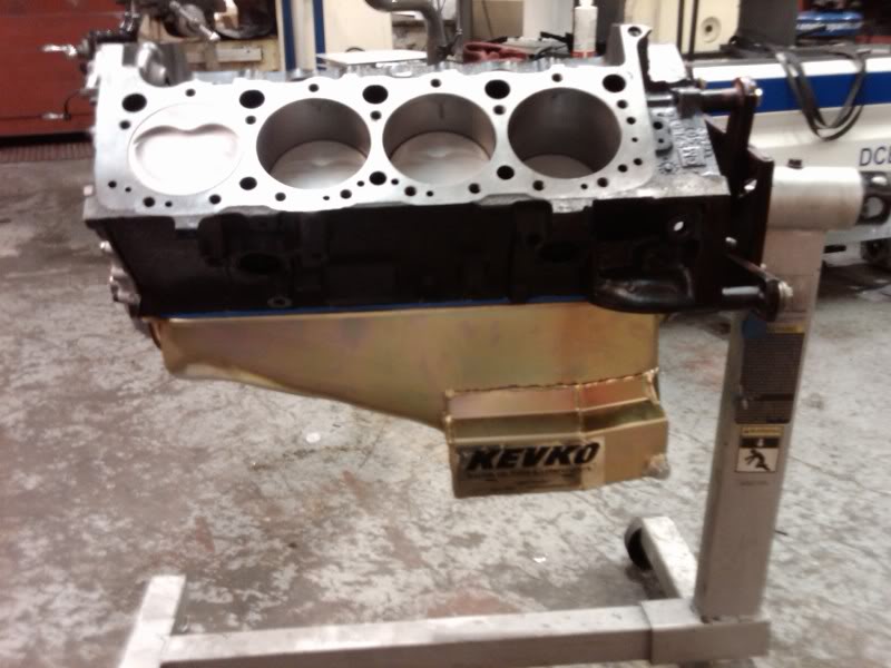

Look into a kevco 7 qt pan they are cheap and work great and they come with a pickup ... i have one on my engine.... i used a meling select high volume pump in mine ...if your gonna drag race or have solid motor mounts you need a select pump
heres a picture...

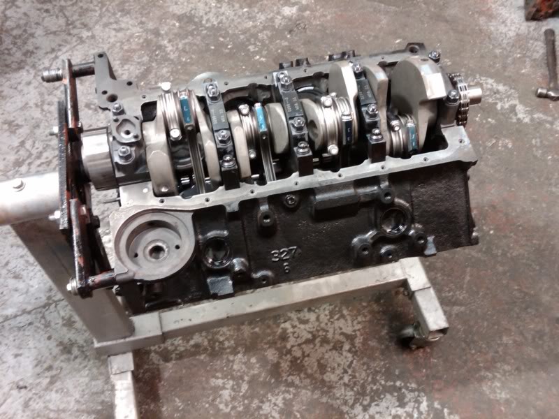

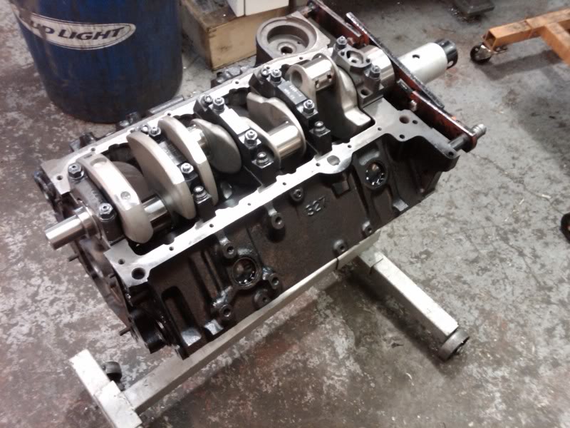

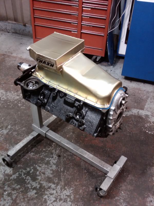

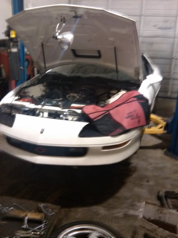

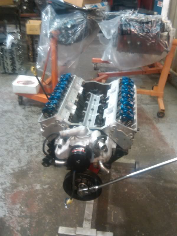

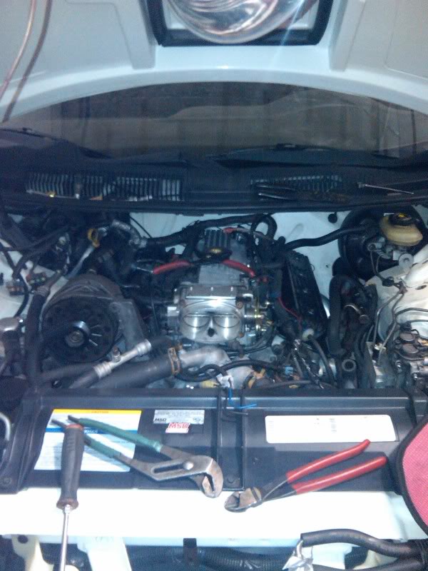

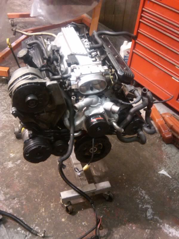

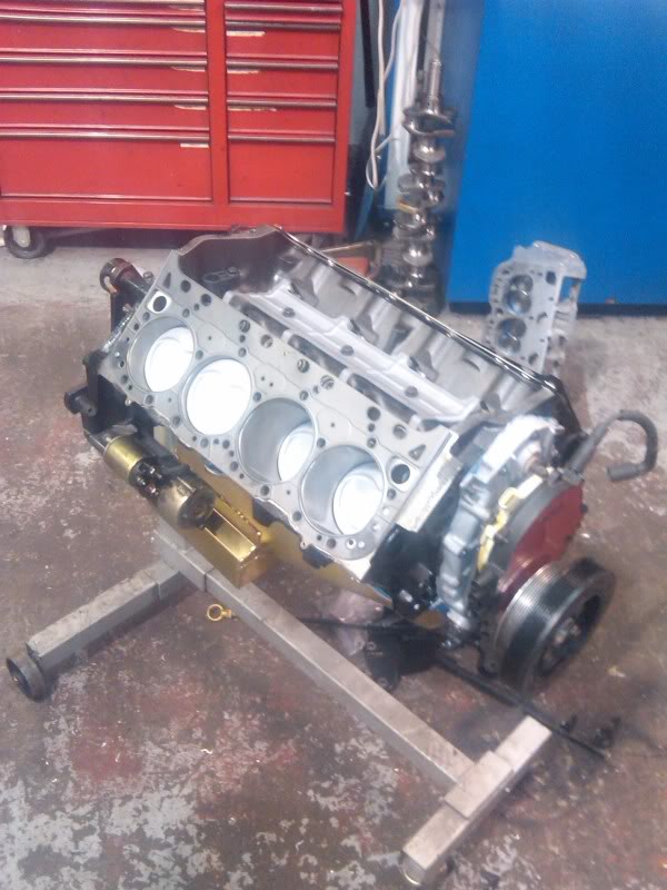

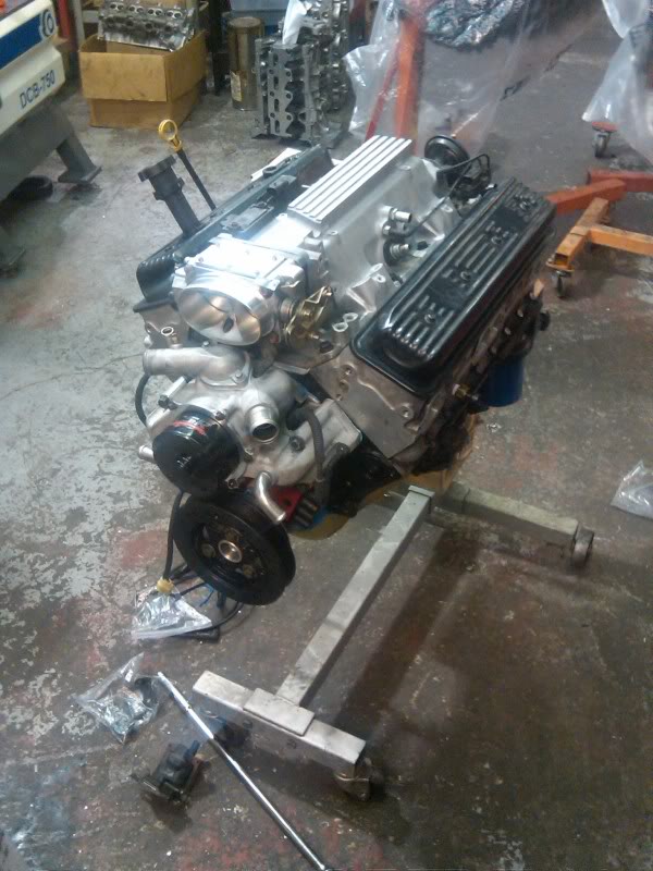

here some pix of my build...just because... its a shame i didn't even get it tuned yet and i'm pulling it back out to put heads and an intake on it ... its got 500 miles on it lol o yea once i looked at my pictures i thought of something else you might wanna do... get your machine shop to cut a keyway in your balancer hub.... its cheap insurance...
