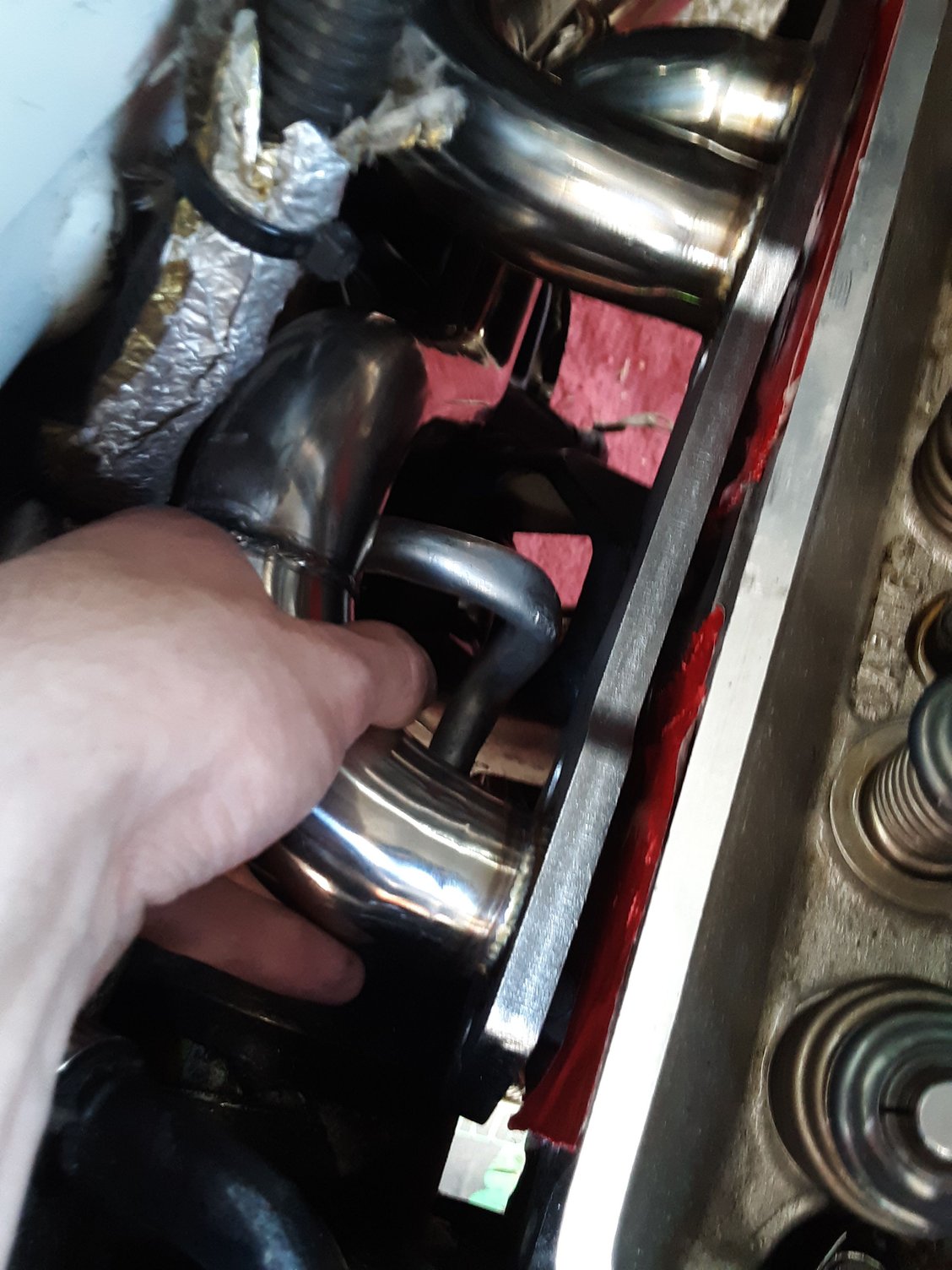

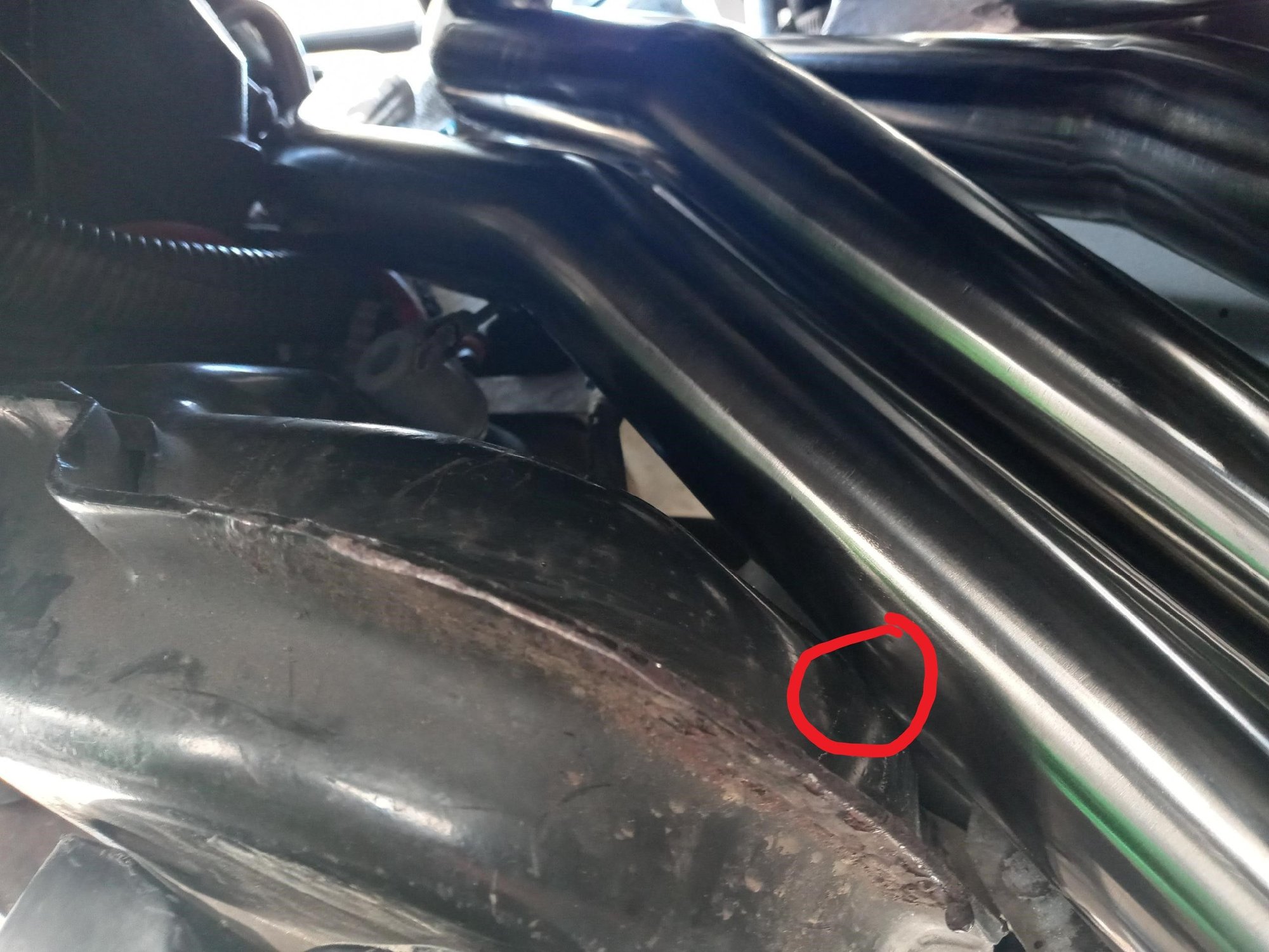

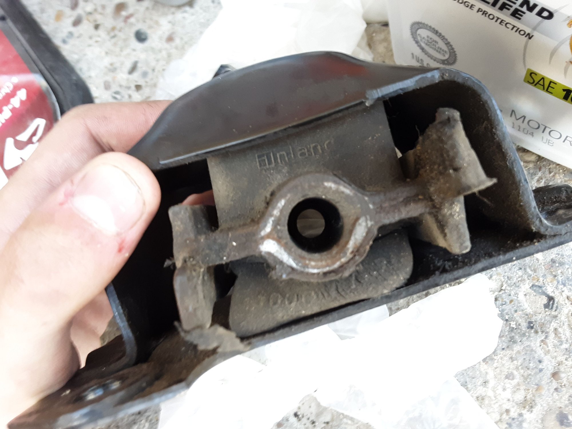

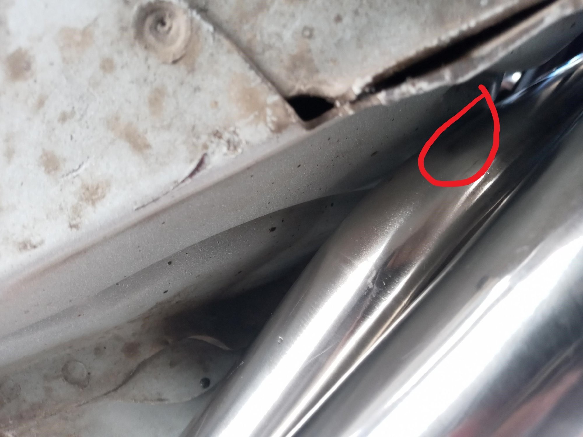

Bolting on a new set of Speed Engineering stainless steel long tube headers this past week but I'm running into an issue on the passenger side. My driver side bolted up perfectly the first time and fits like a glove. After bolting on the driver, I attempted to mount the passenger but ran into clearance issues on the k member and the rear firewall (pictures below). I figured my engine mounts had likely begun to sag and were causing the issue. After removing and replacing both engine mounts with rubber replacements, it is clear the old passenger mount was beginning to sag (picture below). After replacing both mounts, the header is still contacting in multiple areas. I cannot actually get it close enough to bolt it on properly, picture below to show how close I can get it. My transmission mount is polyurethane and is in good shape, what other issues could cause this clearance? Is it possible to install any of the engine mounts incorrectly? I understand it is not uncommon to have to "clearance" a few areas, but I believe most can usually bolt the header on. Any ideas as to how to resolve this would be greatly appreciated.

There is at least a good half or maybe even three quarters of an inch needed to mount it. I'm not worried about a small loss of power, but I've held off on denting the header while talking with Speed Engineering. How well would a propane torch and hammer do the trick? Or is oxyacetylene usually the better bet for stainless steel?

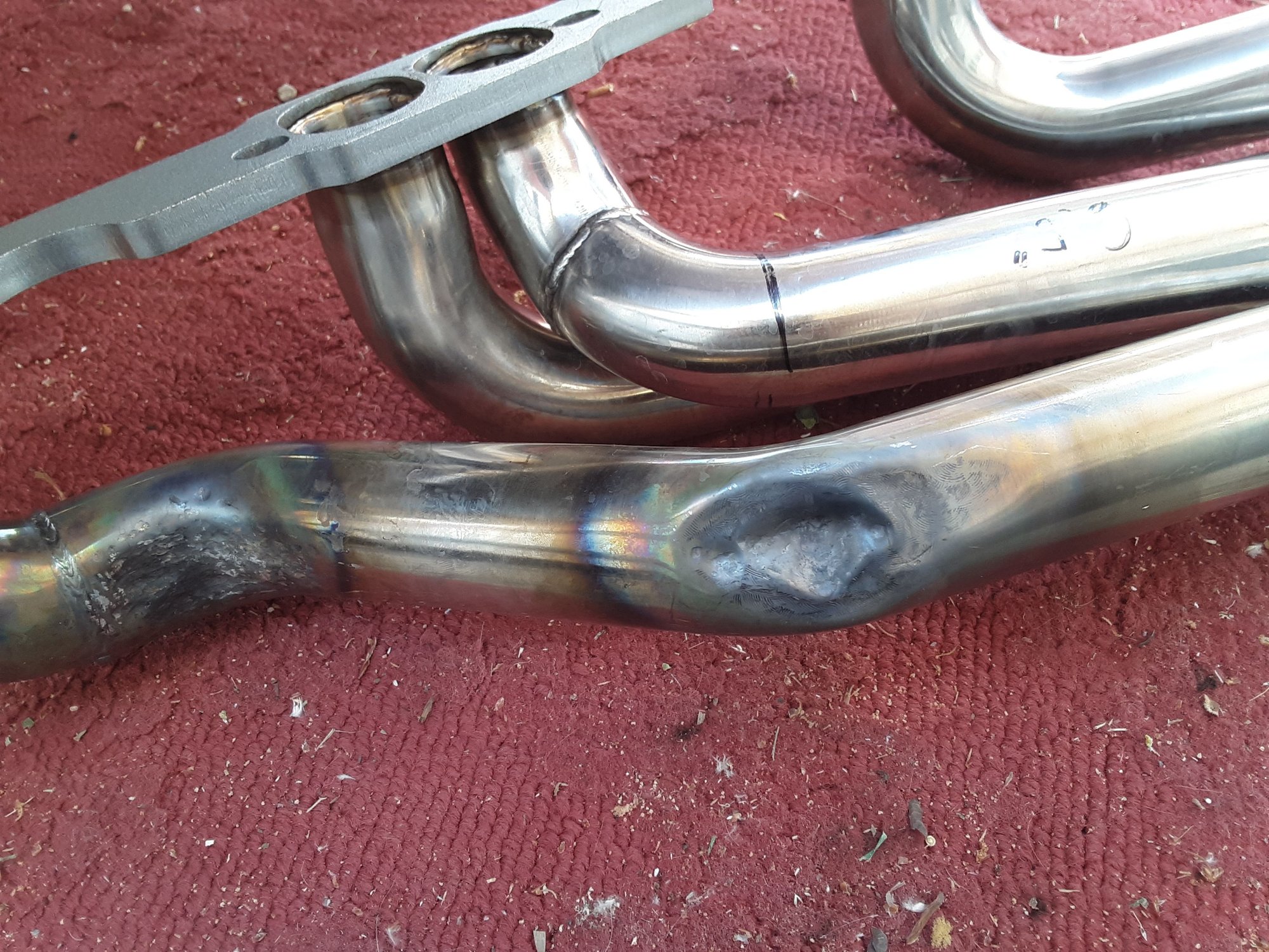

I would think a propane torch with time and a heavy hammer would do it. Make sure you are able to put in in a position where you have solid support behind the tube so you get solid impacts from your hits.
Previous to engine masters, I would have also been worried about performance from denting the headers, but they beat the crap out of headers and it made zero difference. You could also take the opportunity to see if there are any changed around the primaries near the plugs that would make changing plugs easier. I have most frequently seen heating, then hitting the round side of an impact socket for clearance.

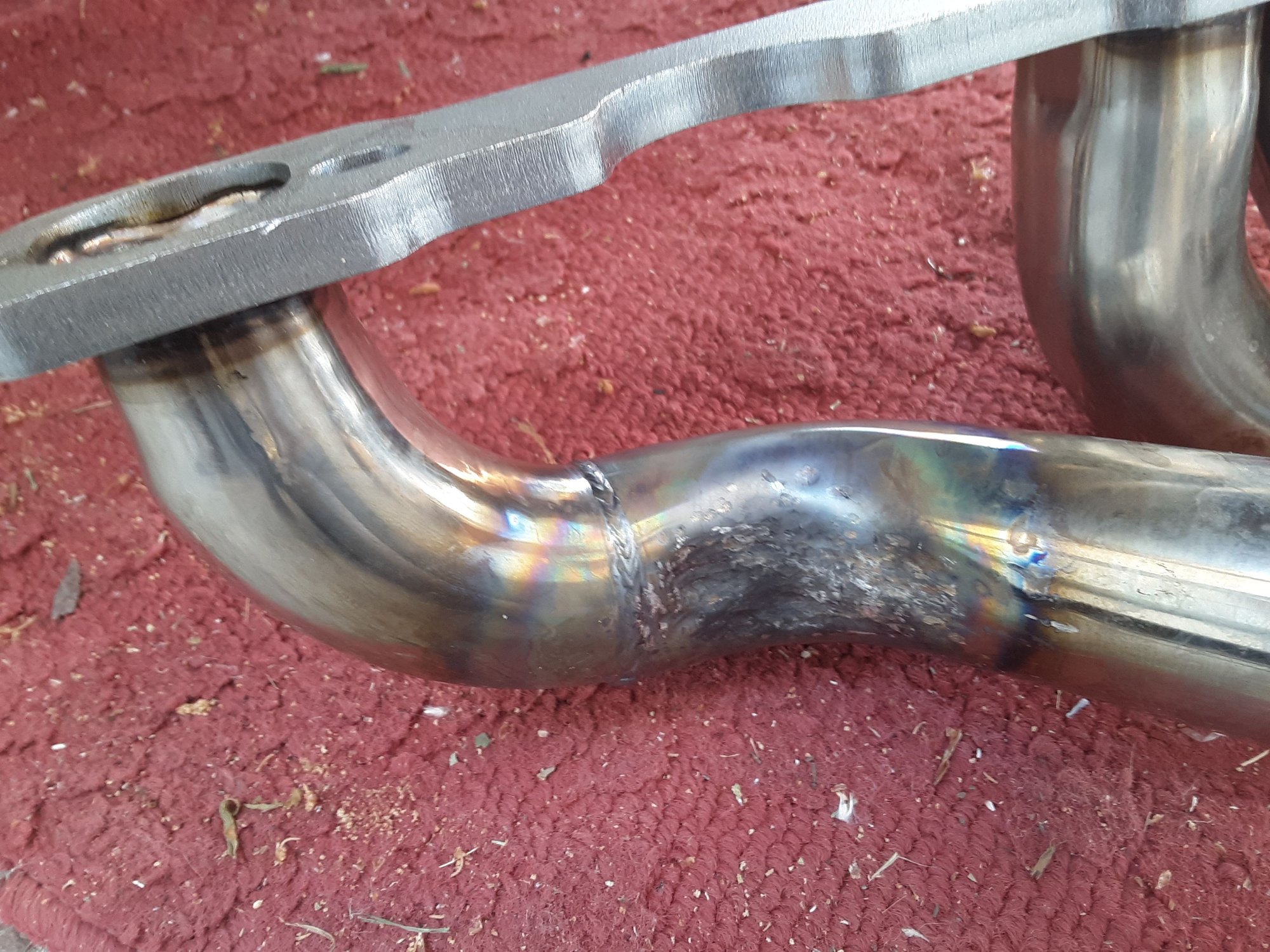

Lots of heat and hammering later, the header is finally in without any contact. I'll include pictures below of what it took in order to make the header fit. The passenger engine mount bracket caused the most difficulty, I also had to add some extra clearance for the ac line that lies below the header on cylinder number 2. There is a few papers width between the k member, just enough to not touch. It's not pretty but it will do the job.
