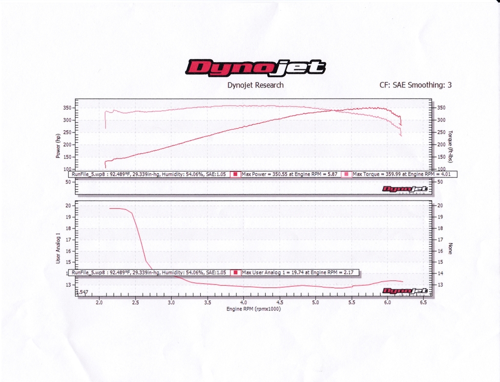

dyno jet. I'll post a pic of graph...notice how it dies after 6k..

The conservative formulas for sizing injectors recommend that you not exceed 80% duty cycle, to prevent the injectors from going static, or simply flowing less than they are rated for, with a poor spray pattern. My less conservative rule-of-thumb is 85% max. If you assume that limit, assume a brake specific fuel consumption (BSFC) of 0.476 #/HR/HR, you come up with a handy formula for normally aspirated applications that says multiply FLYWHEEL HP X 0.07 to get the minimum recommended injector size.
With your goal of 400 rear wheel HP (~460 flywheel HP), that would result in a recommended 32.2 #/HR injector. Why not just go to 36 #/HR and allow sufficient fuel for days when you can make more than the dyno chart HP due to dense air - high barometric pressure, low air temp, low humidity?
