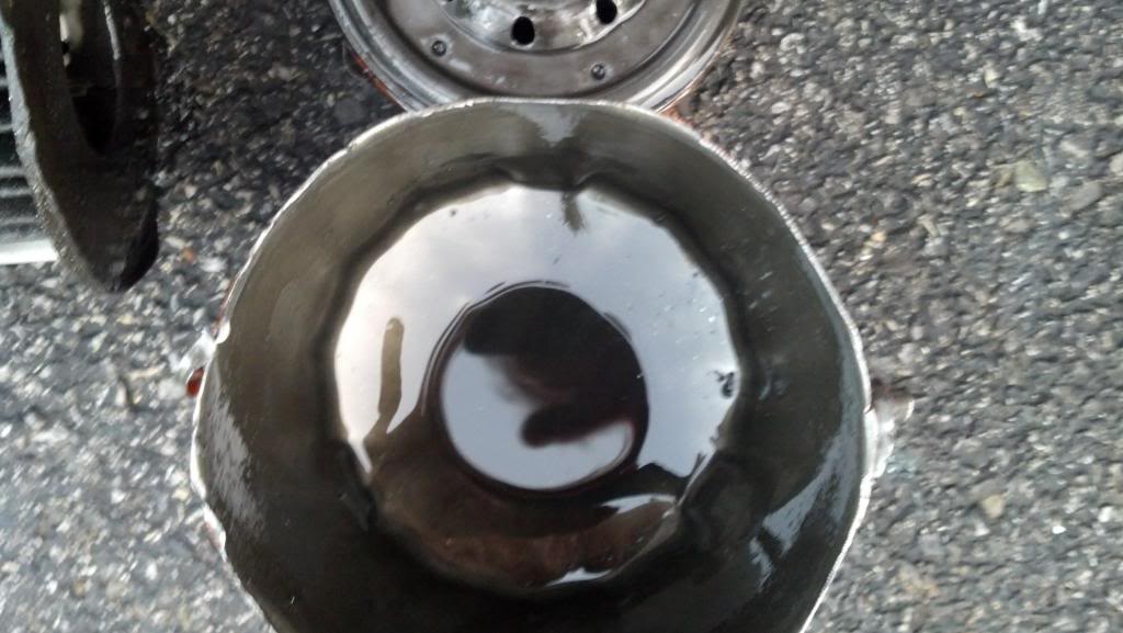

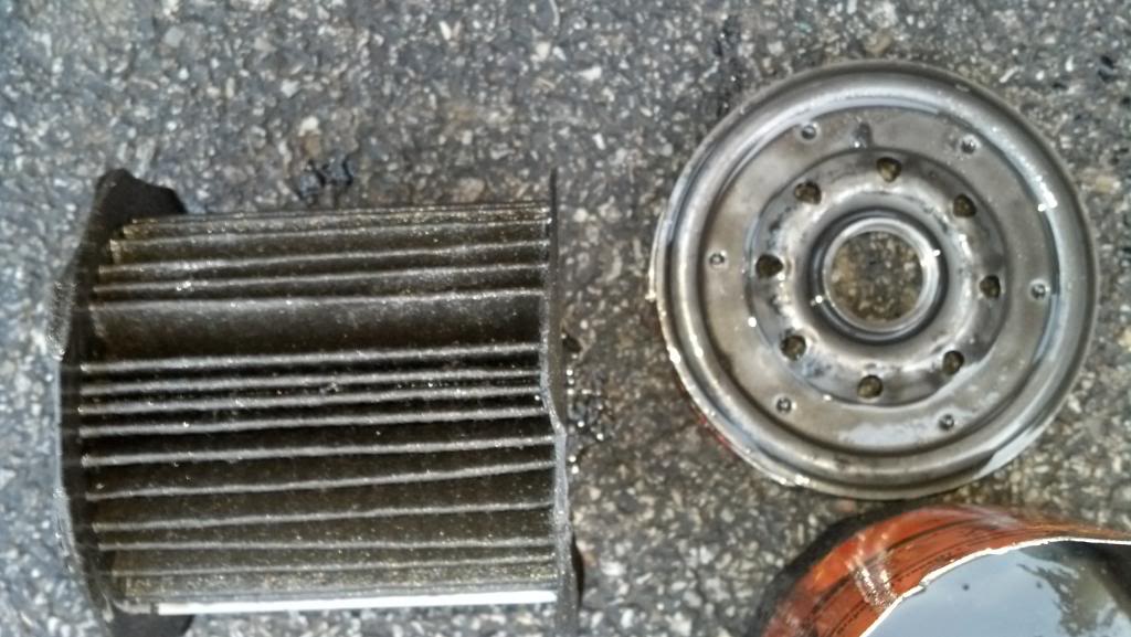

I stopped down after work and asked them about degreeing the cam.. They didnt think that was the issue and were leaning towards the "chirp" in the motor.. I saw the thread where 15hp was gained w/ the cutouts.. I would hollow out the cats in a heartbeat.. Looking forward to hearing what they find when they drop the pan.. After inspecting the oil filter didnt seem too bad?? I understand any metal in the oil is bad.. Seems like some is to be expected after all the new parts.. fingers crossed.. I want the car back bad.. To warm to be driving a winter beater..

they pulled pan and 3 rods all shot.. pulled 1 main cap bearing spun.. said it looked like it has been going on for a while.. The low oil sensor had layers of metal on it..

After seeing your pics, spun bearing was my thought too. Had the same problem on my ride on the dyno. Low power, metal in oil. Sorry to hear it.
